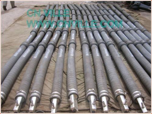

Also, the mass/surface ratio. For effective heating you need that heat transferred, and with a big fat conductor it has less surface to similar weight (weight means price). So if you need that heat outside then even for big currents it is better to split the current => connect heating elements parallel.
Unless you want to use the heat directly, like in an arc furnace or such. Then high currents might be the way to go, but then you better think about 'cables' like these:
