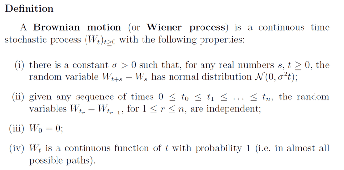

I need to show that (Wt)2 is a brownian motion
So let Vt = (Wt)2
I need to first show that Vt+s - Vs ~ N(0,t)
Vt+s - Vs = (Wt+s)2 - (Ws)2 = (Wt+s + Ws)(Wt+s - Ws)
(Wt+s - Ws) ~ N(0,t)
But is (Wt+s + Ws) ~ N(0,t)?
If it is what happens when I multiply two RV's that are normally distributed together? What can I say about the variance of the new distribution?
Thanks

You are being asked to show something that is FALSE: W_t^2 is not a Brownian motion, unless you are using an unusual definition of Brownian motion. The square of a normal random variable is essentially a chi-squared random variable with parameter 1; that is N(0,1)^2 = Chi^2(1).

Yeah sorry, the question was show if it is or is not a Brownian Motion, for some odd reason I assumed it was because the rest of the examples were
How do I show it is not a brownian motion then, which property of a BM does not hold?
Thanks

What properties of BM are you trying to verify or deny? I have seen alternative definitions of BM; which one are you using?

These:
Also in the question I should note that W is a standard brownian motion

Does property (i) hold?
RGV
That's what I was attempting in my original post.
So my brownian motion V is not normally distributed? Not sure how to show that (apart from my earlier attempt)
