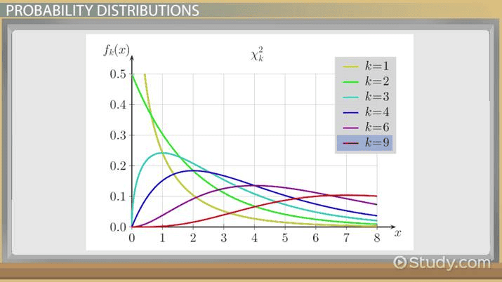

You need to study the random walk in 3 dimensions. I will, out of personal laziness, direct you to this very good Youtube discussion of the Chi- squared distribtion. The derivation of this is not difficult, just slightly tedious to LaTeX.
Now you see that the distributon of r will follow the $${\chi}^2 (3)$$ the chi-squared distribution with 3 degrees of freedom
Notice that for dimensions one and two, the likely value for r is in fact zero as your intuition seemingly demands But in dimensions 3 and larger, the likely displacement grows like N √3 where N is the number of steps of unit size.
With apologies for my LaTeX sloth....
