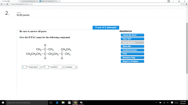

Manh Messages 62 Reaction score 0 Thread starter Sep 9, 2015 #1 Homework Statement Give the IUPAC name for the following compound. Homework EquationsThe Attempt at a Solution However, the 4 and 7 were incorrect in the blanks. I'm not sure what went wrong. Attachments upload_2015-9-9_20-37-19.png 14.7 KB · Views: 577
Dr Transport Science Advisor Insights Author Messages 2,603 Reaction score 785 Sep 9, 2015 #2 I think it is 3-ethyl, 6-isopropyl nonane 3 & 6 are smaller than 4 & 7
Bystander Science Advisor Homework Helper Gold Member Messages 5,628 Reaction score 1,777 Sep 9, 2015 #3 Dr Transport said: 3-ethyl "3-methyl" you mean?
Dr Transport Science Advisor Insights Author Messages 2,603 Reaction score 785 Sep 9, 2015 #4 yes... methyl as opposed to ethyl...
Manh Messages 62 Reaction score 0 Sep 9, 2015 #5 Dr Transport said: I think it is 3-ethyl, 6-isopropyl nonane I wonder if you are counting # of C in this order like this: Attachments Untitled 2.jpg 23.1 KB · Views: 491
