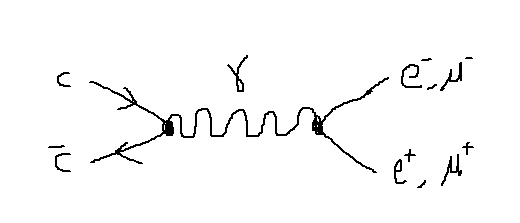

Part(c)
EM decay of J\Psi to either ##e^+e^-## or ##\mu^+ \mu^-##:
Feynman diagram: a c quark and a c-bar antiquark annihilate into a wavy photon line, which then produces an e- and mu- pair and an e+ and mu+ pair. The photon is labelled gamma.

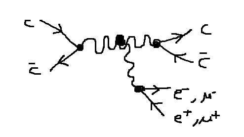

Possible reaction for ##\psi^{'} \rightarrow \chi_0 + \mu^{+} + \mu^{-}## or ##\psi^{'} \rightarrow \chi_0 + e^{+} + e^{-}##
Handwritten Feynman diagram: a c quark and c-bar antiquark annihilate into a wavy gluon line with two vertices, which emits a wavy photon line ending in e-, mu- and e+, mu+ pairs; the c and c-bar on the right are shown as an outgoing pair.
For decay to ##\chi_1## and ##\chi_2## only ##e^{-}e^{+}## pairs are allowed.
