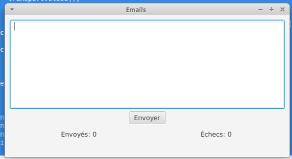

The GUI is as such (the sending label is hidden when the program launches, of course):
Any advice on how to solve these problems is most welcome, especially the second. Thank you very much for your time!
