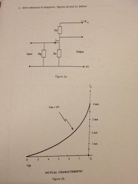

With reference to the diagram attached.
i) What would be a suitable value for Rg and why
ii) If the drain current is 2mA, determine a suitable Q-point on the mutual characteristics and hence obtain a value for Rs[/B]
i) I chose a 2.2M ohm resistor and said that the value of the resistor has to be this large in order to keep the impedance high. Is this correct?
ii) I don't understand how to start this question as I don't have enough variables. I have the Vds and the drain current which is the same for the source current, but how do I go from there? Is there a way to get the Vgs from the mutual characteristics graph?[/B]
Yes, it keeps the input impedance high. In this particular method of biasing the JFET, the exact value of RG is generally specified as "large".

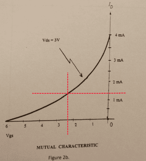

Yes. You are constrained to have ID of 2 mA on the y-axis, so what is the corresponding VGS on the x-axis (to be on the VDS = 3 V curve)?
So if I take Vgs at say 1.4V? How would that allow me to get the source voltage?
Would it be Vs = Vg - Vgs, so that would be Vs = 0 - 1.4V, making the source voltage 1.4V, making Rs = 1.4V/2mA = 700 ohms.
Then...
Vd = Vdd - Vds - Vs = 12 - 3 - 1.4 = 7.6V, so that make Rd = 3800 ohms
Some signage issues. VS does equal VG - VGS, but I think VGS is really -1.4 V (per the graph--note the odd leftward-increasing x-axis).
So you would properly say VS = 0 - (-1.4 V).

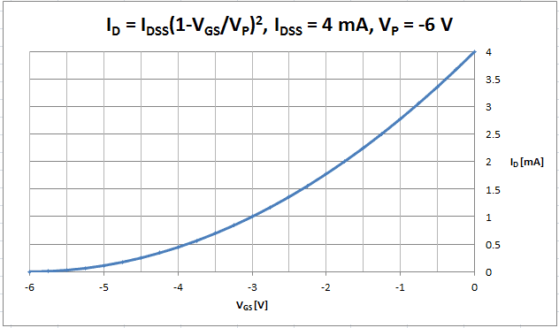

I did Id = Idss (1- (Vgs/Vp))^2, so Id = 4mA (1- (-1.4/-6))^2 = 2.37mA
Then referring to the graph using 2.37mA, Vgs would = -1 so transconductance = 2.37mA/1 = 2.37m mho? Is that correct, I watched a few videos and took a go at it. I'm laying in bed rn at 6am trying to figure this out so I'm not 100% sure, haha.
That equation is for the "mutual characteristic" graph that you attached in your OP. If you compare that with this (a plot of the equation):
You might get different numbers, visually. For the above plot, 2 mA looks like it corresponds to -1.75 V. Whereas the image in your OP indicates, what, -1.4 V?
So pick one (the equation or the image) and stick to it and don't jump between them.

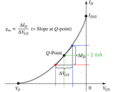

You can answer the new attached question because they give you ΔID and ΔVGS. But you don't have the same information for your OP question. So, two ways to proceed:
1) Realize that what you are looking for is the slope of mutual characteristic curve at the bias point (interchangeable with Q-Point). Can you get this slope? If so, you are done.
or
2a) Inject a small signal about your VGS bias point. Say, 1 V peak-to-peak.
2b) This will give you two new points at VGS,bias + 0.5 V (blue point) and VGS,bias - 0.5 V (red point).
2c) From these 2 points on the curve, you can get the corresponding ID values.
2d) You have ΔVGS = 1 V, because that is what you have injected.
2e) And you also have ΔID from what you did in 2c.
Here is an image stolen from the internet to drive the point home:
It's fuzzy because it's free!

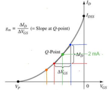

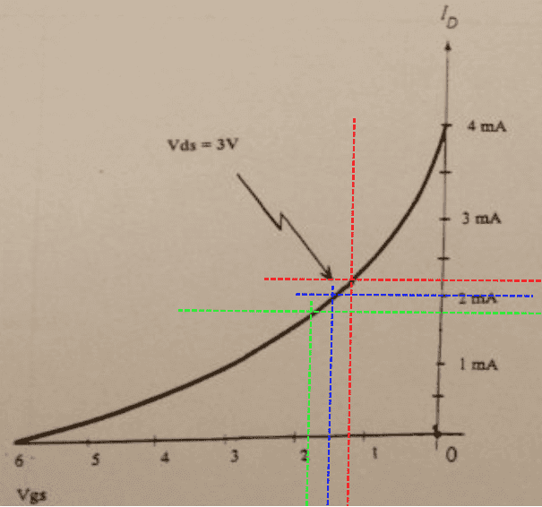

so is this right:
if I vary the Vgs 1V, it would make Vgs go to 2.4 from 1.4, which would then make Id = 1.3mA looking at the graph, so the change in Id would be 0.7mA with the change in Vgs being 1V, so the answer using the equation would be 0.7m mho? yes?
So...your result is close, but accuracy (and your method) could be improved. The main source of error is the fact that you are not varying VGS about the operating point (or bias point, or Q-point). You are deviating from instruction 2b. You are using points at VGS,bias (green point, sorry was black in post #11--changed for consitency...) and VGS,bias -1 V (orange point).
The slope at that point (the red point) is going to be slightly flatter than the green point. However, if you rounded your result to 1 mS (use millisiemens now-- in 1881 the mho was replaced by siemens), you would have a good enough answer, considering you have 1 significant digit to work with.
ΔVGS = 0.2 V,
on graph ΔID = 0.2mA when ΔVGS = 0.2 V,
mutual conductance = ΔID / ΔVGS = 0.2mA / 0.2V = 1m mho
