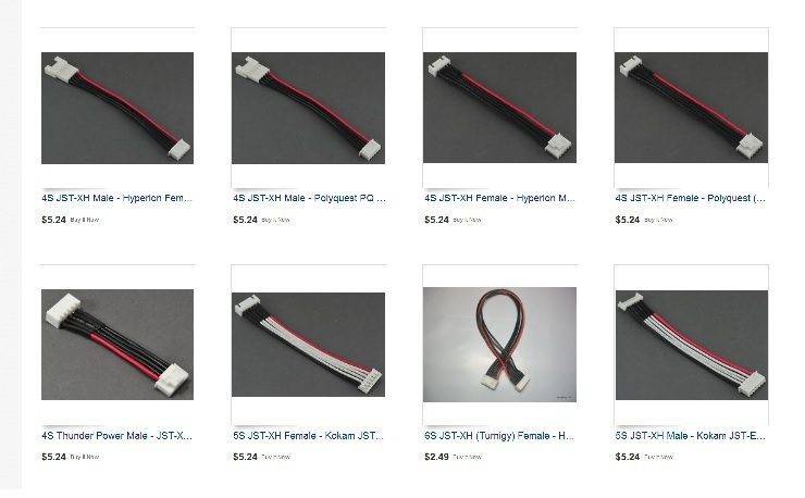

Actually I am not even sure it is JST.
Long story short: I have two devices that I have to connect, but they use different connectors (I am perfectly sure it is OK to connect them, one is a balancer cable for multicell LiPO battery, the other is a balancer board for a LiPO charger).
There is an adapter board with male connectors, and a female plug. Unless my eye sight fails me, plugs on the board are 2 mm apart, pins in the plug are 2.5 mm apart. That suggests JST PH and JST XH connectors - but I am not sure. Can anyone comment? I can take another picture from the side if needed, just tell me.
I am not convinced I will make one, could be I will just look to buy one, but I want to know the type first (to prove to some people they are idiots ;) ).
Yep. Looks that way to me also. So http://www.ebay.com/itm/like/230652551778?lpid=82 (Scroll down to see other pin count adapters).
Looks like of those similar (I have a 3S battery) would do the trick. But after combining keywords from your posts and several places I visited I was able to google this page: http://www.tjinguytech.com/charging-how-tos/balance-connectors - and I am definitely starting to see how these things are organized in the RC model world.
