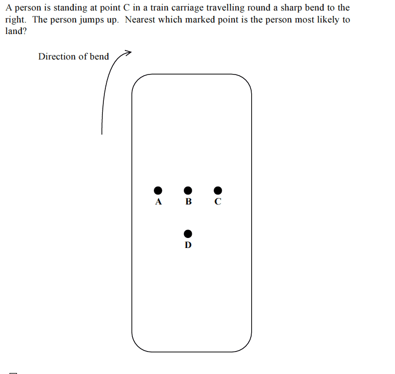

imagine a train that is moving straight and a man jumps as it moves to the right around a sharp bend.
There are 4 point labelled A,B,C D where:
A=position of person before he jumps
B= position a certain distance to the left of A
C=position twice distance of B to the left of A(ie BC=AB).
D= a position behind A and AD=AB.
When the train turns right, which is the closest point where man will land.
I know the answer but don't understand why.

sorry - just noticed attach files. This will make it easier. It is now attached. The option is either A,B,C or D.
Thanks

So now that you have clarified the question (which, sadly, remains bogus), can you support your argumentation in favor of C or D being the right answer?
Can you support your argumentation against A and B?
using the lettering in the diagram, not the one given in the first description, I actually think he would land on c or D. The reason is that initially, as shown in diagram the train is due North just before man jumps so the man travels due North in the air. The speed determines if he lands closer to C or D which makes the question very complicated and does not contain sufficient data for calculations. In fact the i think the moree confusing it gets because now i am thinking D is possible. The only on i can eliminate is A because the man moves North as the train turns right and A will always be behind him(not necessarily directly behind him).
Slow down and actually explain your reasoning this time.
The man travels due North in the air. Great. But that does not tell how the train moves beneath him.
How does the speed make a difference? What happens for a slow moving train? What happens for a fast moving train?
While you are busy changing the speed of the train, what other things are you holding constant? The radius of the curve? The angular rotation rate of the train? Something else?

Assuming the train's speed does not change, which way would the man accelerate if he stayed at the same point in the carriage? What force causes that acceleration?

According to posted diagram, C=position of person before he jumps.
Do you mean he would land on C?
When the train beginns turning to the right, what would happen to a luggage with wheels that is not restained respect to the floor of the train?

It states 'sharp bend' so am assuming this means that the track curves very quickly to make a right angle ie a small curve. Irrespective of speed, when the man jumps and assuming the train quickly turns to the right , the speed of the man in the North direction is greater than that of the train so he will travel further than the train in that direction so he will move away from C. Depending on how long he is in the air he could land near B or A. Although I eliminated D during my earlier thoughts, that is now a possibility.
As fro the trolly/suitacase, if the train suddenly moves to the right then the momentum would keep the trolley moving due north. But this still does not help.

The centripetal force which acts inwards. But the man is in the air and as he and train are moving North just before he jums he carries on moving North in the air.
That is correct. How does that help you decide where, with respect to points ABCD, he is likely to land? Imagine an oriented frame of reference fixed on the ground. The labeled points on the train and the passenger are all moving relative to this frame. Can you draw the paths (seen from above) of the 4 points in that frame? What about the path of the passenger while he is in the air? How do you interpret what happens when two paths intersect?

If the track makes a right angle turn and the train car makes this turn within the time that the jumper takes off and lands, what sort of acceleration would that imply for the front and rear of the car. Is that realistic? Does that, perhaps, temper what might reasonably be meant by "sharp"?
If the train car is to negotiate a 90 degree turn within the time frame for a jumper to take off and land, does this put any constraint on the speed of the train car?

Inwards to the curve, yes, but which way in terms of the frame of reference of the train?
Had he not jumped, what would have provided that force?
So which way will the man accelerate relative to the train when that force is removed?
friction provides centripetal force so if no friction the man would slide radially. Sill can't see how to figure it out. To me the question is vague and and have assumed the paths is a right angle for simplicity rather than a circle although a slight curve is obviously needed.
Yes! Stick with that.
But I am convinced that the question has been incorrectly stated. It surely intended that the man starts at B.

I do not like the question much. But if one applies some real world constraints on how high one can jump, how wide rail cars are and how fast they move one can prune it down to two answers. Given how physics teachers think, one can prune that further and divine an intended answer.
1. Rail cars do not turn by 45 degrees during a jump. So choice D is out. The deflection will be mostly centrifugal.
2. Rail card are wider than the height of a jump. And they do not accelerate at 1 g. So choice A is out. The jumper won't deflect that far relative to the car.
That leaves choice B (significant movement outward) and C (negligible movement outward). A physics teacher who wrote "sharp bend" is not going for an answer saying that the effect is negligible. (Though in my estimation with a reasonable rail car at a reasonable speed around a reasonable curve, the deflection will be closer to zero feet than to three).

I doubt the question is intended to be that subtle. The most likely to me is that the man is supposed to start at B and finish at A.

I think that there is a clear cut answer to the problem as posed, under the following assumption: The turn is executed by an acceleration ##\vec a=a~\hat x-a~\hat y## with the speed of the train remaining constant at ##v_0.## This acceleration is "on" during the time interval ##0 \leq t \leq v_0/a##. Over this interval the speed of the train changes from ##v_0## northward to ##v_0## eastward.
With only this assumption we can write kinematic equations for the man and points A, B, C, and D relative to an inertial frame at rest with the ground and with the origin at the position of A at t = 0. Let ##x_0## be the separation between nearest neighbors. Then, while the man is in the air, we have position vectors $$ \vec r_{man}=v_0 t~\hat y~;~~\vec r_{A}=\frac{1}{2}at^2~\hat x+\left(v_0 t-\frac{1}{2}at^2\right)~\hat y$$ $$ \vec r_{B}=\left(x_0+\frac{1}{2}at^2\right)~\hat x+\left(v_0 t-\frac{1}{2}at^2\right)~\hat y~;~~ \vec r_{C}=\left(2x_0+\frac{1}{2}at^2\right)~\hat x+\left(v_0 t-\frac{1}{2}at^2\right)~\hat y $$ $$\vec r_{D}=\left(x_0+\frac{1}{2}at^2\right)~\hat x+\left(-x_0+v_0 t-\frac{1}{2}at^2\right)~\hat y. $$ The distances between the man and each of the four points are $$d_A=\left[ \left(\frac{1}{2}at^2\right)^2 + \left(-\frac{1}{2}at^2\right)^2 \right]^{1/2}~;~~d_B=\left[ \left(x_0+\frac{1}{2}at^2\right)^2 + \left(-\frac{1}{2}at^2\right)^2 \right]^{1/2}$$ $$d_C=\left[ \left(2x_0+\frac{1}{2}at^2\right)^2 + \left(-\frac{1}{2}at^2\right)^2 \right]^{1/2}~;~~d_D=\left[ \left(x_0+\frac{1}{2}at^2\right)^2 + \left(-x_0-\frac{1}{2}at^2\right)^2 \right]^{1/2}$$Note that these are the distances at any time ##t##, including the landing time which need not be equal to the time ##v_0/a## required for the train to complete the turn as the question does not state that it is. When the negative signs in the squared terms are taken care of, it should be obvious which distance is the shortest and addresses the original question "which is the closest point where (the) man will land?"

You cannot get into mathematics until the interpretation is nailed down.
With @haruspex interpretation, A is the obvious choice.
