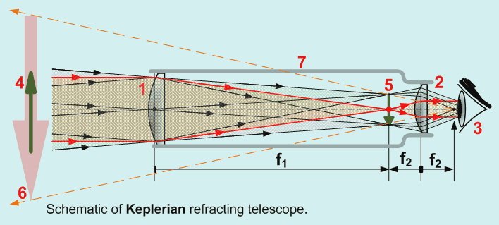

Welcome to PF.
Can you post a link or two to information about Keperian telescopes and maybe use "Attach files" to upload a typical image of one? Then can you say more about why anything needs to get modified? Thanks.
Ray diagram of a Keplerian telescope: parallel rays enter the objective lens, converge at a focal point marked by a dashed line, then diverge through the eyepiece lens, labelled fo and fe for the two focal lengths.
Schematic of a Keplerian refracting telescope with numbered parts 1 to 7, showing parallel rays entering the objective lens, forming an intermediate image, and passing through the eyepiece with focal lengths f1 and f2 marked.
Beams are not focused after the second lens. The telescope forms a virtual image. But I need form a real image after telescope to record image on chips.

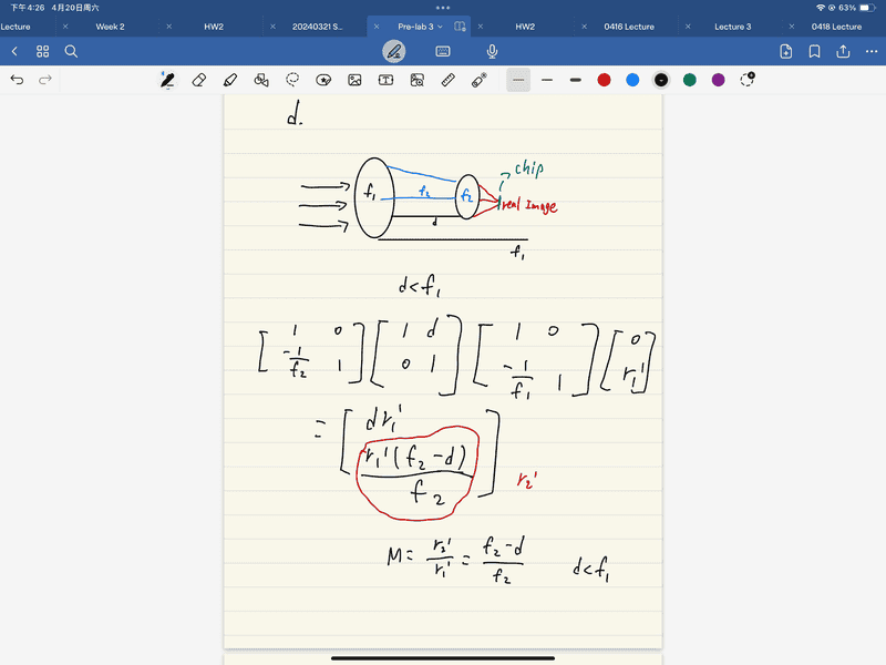

I tried to achieve the task with only 2 lenses. I moved the second lens to the left of the right focal point of the first lens. I can indeed obtain a real image. However, after using ABCD matrix to calculate the angular magnification of the system, I found M<1, which means it is a microscope not a telescope..... Is there a way to achieve a telescope with only two lenses? It is part 1d. Thank you!

Handwritten ray diagram of two converging lenses f1 and f2 separated by distance d, with a red real image marked after the second lens, followed by ABCD matrix product and magnification M = (f2 - d)/f2 for d < f1.
Isn't there already a real image in the drawing you posted of the Keplerian telescope? Can't you just put the CCD there?
