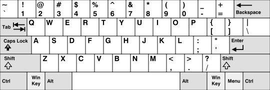

In windows 10 when we are using a language can we use a different keyboard belonging to another language. For example can we use win 10 in English but can we use a French keyboard layout.
Thank you.
When you say different keyboard do you mean you want to physically switch to a different keyboard.
french keyboard:
vs english keyboard:
During internationalization testing, a programmer did this in my group. He decided to swap out his english keyboard for a french one and discovered that he couldn't login. The reason was his password had an A in it so he realized he couldn't press the French keyboard A but instead had to type the French keyboard Q which was in the same physical location.

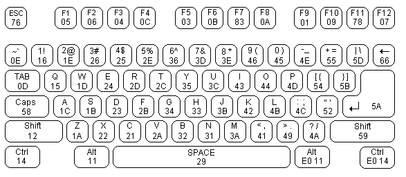

Basically the printed keycaps are there for us to type with. Pressing a key on the keyboard sends a scan code to the computer. The computer uses a scancode to character table which maps the key to the correct character.
Here's a keyboard with scancodes:

Did you read my post on keyboard scan codes?
This is why you can't just plug in the french keyboard because the keycaps are switched around some.
