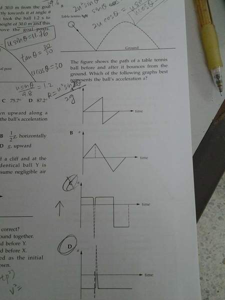

Pictures of the questions are attached below.

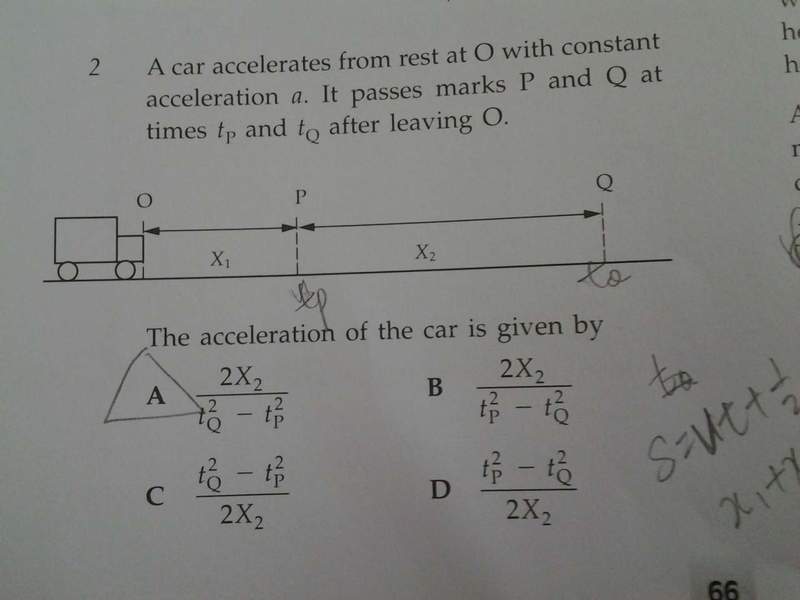

For question 2, I totally cannot get any answer from the four choices after I substituted everything in the equation.
For question 4, I used V^2= U^2 + 2AS, with U being zero, A being 9.8 and S being 2.0. I got C but the answer is D. Can someone explain it to me?

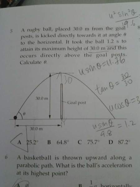

For question 5:
Firstly, why can't I calculate theta by directly using tan θ = 30/30 which makes θ=45°?
And how do I get the answer?
I have used (u sin θ)/9.8 = 1.2 but there are still two unknowns (u and θ). I can't find another equation to do simultaneous.
What equations did you use? (Note that you can immediately eliminate several of the choices based on units.)
The initial velocity isn't zero.
For question 5:
The angle formed by that 30/30 right triangle is not the same as the angle of the trajectory. (It would be if the ball just went straight, but it doesn't.)
That's one of the equations you'll need. Find another relating to distance.
s= ut+ 1/2 at^2.
Based on units, the choices left are A and B.
So is that equation correct?
Why?
The helicopter goes up with a steady velocity, so it's motion is controlled, not free fall or projectile motion right? So how can I determine it's velocity when it's at a height of 2.0m?
Furthermore, when the commando jumps off it, why isn't his velocity zero? How come the commando have a velocity the moment he jumps off?
I used the range equation, and I found that u^2 sin 2θ = 588.
Then I made it: 2 u^2 sin θ cosθ = 588, then divide it by u sin θ = 11.76
so u cos θ = 25, which makes u tan θ = 25/11.76.
∴ θ= 25.2. Is this the way?
(TO LENGTHEN THE REPLY TO FOUR CHARACTERS. HOHOHO.)
coconut62 said:
s= ut+ 1/2 at^2.
Yes. Hint: Apply it twice.
Why?
You are given the velocity of the helicopter.
Because he is moving along with the helicopter.
That's a fine way to do it.
You can also use an equation for the horizontal distance:
u cosθ 1.2 = 30.

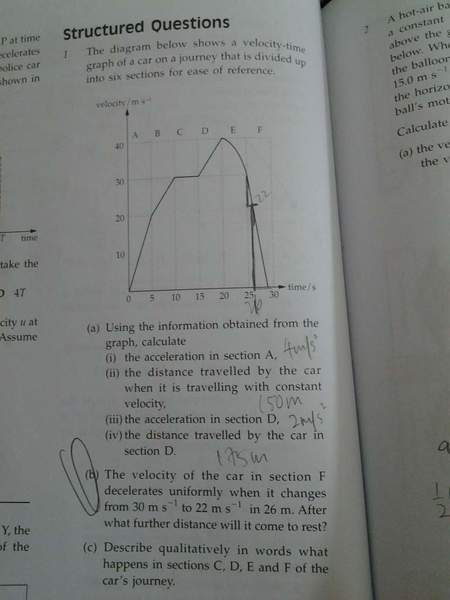

New questions
For the objective question, the answer is D.
I understand why it is negative, but I don't know why it needs a little time for the acceleration to become zero. Notice that the dotted lines are not parallel. What happened to the motion of the ball the time when it's going to touch the ground?
For the structured question, it says velocity decreased from 30m/s to 22m/s, and distance is 26m. So I used the area under graph: 1/2 x (30+22) x t = 26, which makes t=1. My understanding is that the deceleration took 1s. Then, I calculate the remaining displacement by using the remaining area under graph: 1/2 x 4 x 22 = 44m. How come the answer is 30m?
When the ball touches the ground, the ground exerts an upward force on the ball to change its velocity. The force isn't infinite, so it takes some short time for the ball to rebound off the floor.
Looks good. So what's the acceleration?
Where did you get the 4 from? Figure out the time it takes to come to rest.
So what's with the slightly slanting part? Is it because of the friction between the ball and the ground that makes its acceleration decrease? (This idea is stupid, but)
At the exact moment when the ball touches the ground, isn't the acceleration going to become zero straightaway? And remain zero throughtout the short impact time?
Ah, I got it. By using formula. But can you explain why it isn't reasonable to directly calculate the area under graph? It's the distance traveled anyway, no?
Rest time 30 - time after deceleration 26.
No. The acceleration of the ball is not zero during the collision (except for when the ground force exactly balances the weight of the ball, for perhaps an instant). Realize that the ball is squishy. It gets compressed as it rebounds. As soon as it loses contact with the ground, once again gravity is the only force acting.
Nothing wrong with calculating the area under the graph, if you do it correctly.
Take another look. It comes to rest before time = 30.

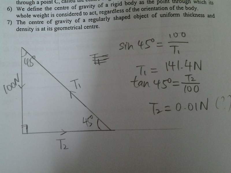

2. Value of T2 is totally unreasonable. How should I arrange the forces? Since the two angles are both 45°, I can either put tan 45 = T2/100 or tan 45= 100/T2. How could that be?

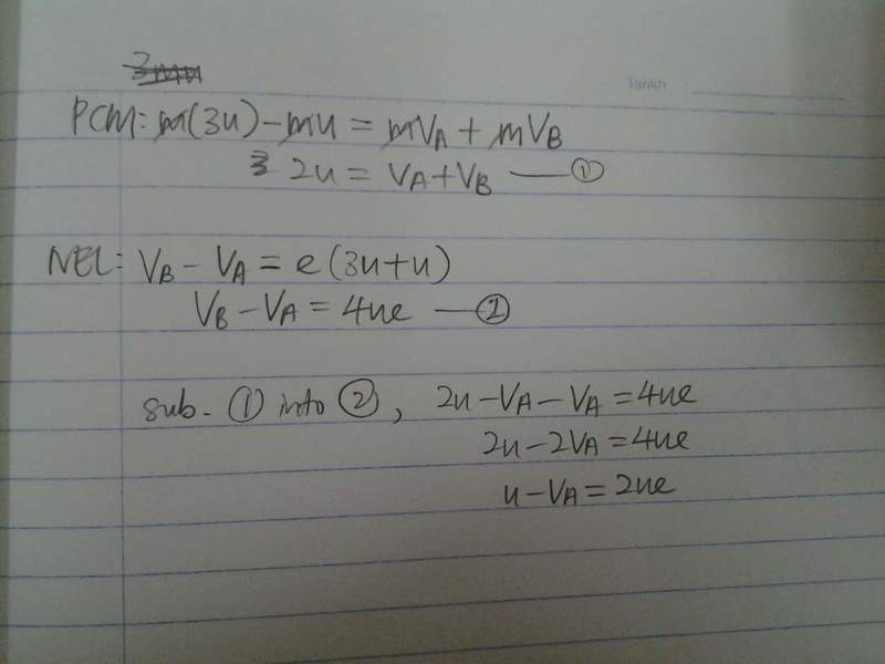

3. Is my working correct? I don't know how to continue. I cannot just substitute e=1/2 into the equation, right? Even if I do, I still couldn't get the value of Va.
Well, what does tan 45° equal? Does it matter?
How did you get a value of T2 = 0.01 N? Check your work.
Unfortunately, I cannot view the picture you linked.
All solved. Bless you.

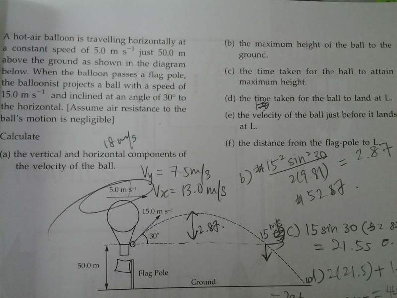

Another question: (Since it's still projectile motion, I might as well continue here)
Please view the second image.
I have problems with d) and f).
For d), I have found the t above the line to be 1.53s. For the part below it, I tried two ways:
1. Vertical component of velocity: 15sin30
t = 15sin30/G = 0.76
2. Height: 50m
t= 50/(15sin30) = 6.67 (?!)
Please explain to me why it's wrong.
For f), I calculate the distance by adding the range of the projectile motion and the horizontal component of the remaining trajectory.
Range = (U^2 sin 2θ)/g = 18^2 sin 2(30)/9.81 = 28.6m
Horizontal component = vt = 18cos30(2.52) = 39.3m
It's wrong. The real answer is 72.9.
*The answer for d) is 4.05s. I minus 1.53 from it and got the 2.52.
Thanks in advance.
Your work is fine. Express Va in terms of u. What minimum value of e will give Va a negative direction?
You can express Va and Vb in terms of u.
2. Height: 50m
Method 1 would find the time for something to reach that speed start from zero. (That's the time it takes to rise to the top.)
Method 2 assumes a constant speed for the descent.
Neither method will work. Why not just use:
[tex]x = x_0 + v_0 t + (1/2) a t^2[/tex]
The horizontal speed is not correct.
And the easy way, once you've found the total time, is just distance = vt (for the horizontal motion). No need for the range equation.
Now I use v^2=u^2 + 2as, where v is the vertical component, u = 15sin30, a=9.8, s=50.
Then I substitute the V value into a= (v-u)/t. t= 2.52s.
Is this the way, or are there any better ones?
What does the o mean?
Is this derived from the s=ut + 1/2at^2 formula?
Ooh, it's 18 m/s.
But (18 x 2.52) + 28.6 is still not the answer. Which part is wrong?
And, please see the image again. I thought I would easily solve e) after I finished d) and f) but :rolleyes:
I used v^2 = u^2 + 2as for vertical component.
v^2 = (15sin30)^2 + 2(9.8)(50), v= 32.2 m/s
Then to find the actual velocity, I calculate v' cos (90-30)= 32.2, which makes v' 64.4m/s which is far from the answer :frown:
That's one way. I would use the formula that I provided.
The 0 signifies initial position and initial velocity. (As in T = 0.)
Yes, same thing.
Ooh, it's 18 m/s.
I believe you misapplied the range equation.
But once you have the total time, finding the horizontal distance is easy without needing the range equation.
That's fine.
You found the vertical component of the final velocity. What's the horizontal component?
R= (u^2 sin 2θ)/g
= 15^2 sin 2(30)/9.81 where is wrong?
And why is the time taken to attain max height (15sin30)/g, regardless of the real height? Wouldn't that be assuming that the ball just went straight?
The other questions are solved. Tq.
*And why is the vertical component of a point at the other side of the trajectory = 0? By other side I mean the part on the right of the symmetrical line.
coconut62 said:
R= (u^2 sin 2θ)/g
Wrong speed and wrong angle. (You need the angle with respect to the ground.)
The height reached depends only on the vertical motion, which is why you use the initial velocity in the vertical direction.
I don't understand your question. Are you asking about position (height) or velocity?
Give me a specific example of what you mean.
Velocity.
Its a projectile motion diagram, an upside down U letter.
There's a point X on the left half trajectory. It's horizontal component is U cos θ, and vertical component < u sin θ. And there's a point Y on the right half of the trajectory(the path the object falls down), it's horizontal component is still ucosθ, but it's vertical component is 0.
coconut62 said:
Velocity.
How can the vertical component be zero? The only place where the vertical component of the velocity is zero is at the apex of the trajectory.
So at any point on the falling path, the vertical component is the same as the mirrored point on the other side?
Then how about the acceleration at the apex?
The same magnitude, but different direction.
The acceleration is the same everywhere, including at the apex.
