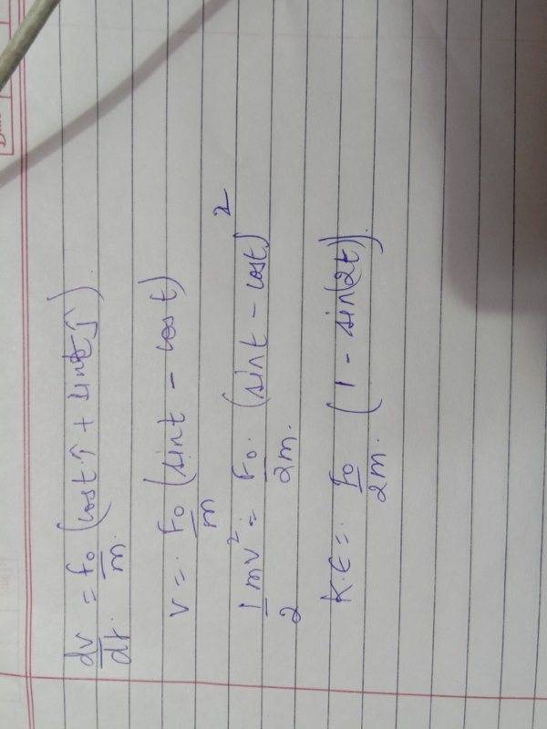

PeroK said:
Can you show us what you did?
  • Handwritten derivation on lined paper, rotated sideways: dv/dt = (f0/m)(cos t i + sin t j), then v = (f0/m)(sin t - cos t), then 1/2 mv^2 = (f0^2/2m)(sin t - cos t)^2, then K.E. = (f0^2/2m)(1 - sin 2t).
PeroK said:
What velocity do you get at ##t=0##?
Ya i got my mistake and got the ans thanks
