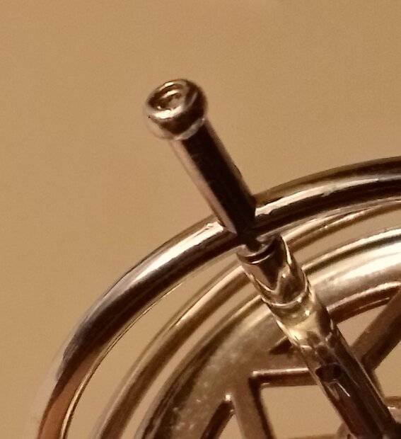

What kind of gyroscope are you using? If it is a simple gyroscope that has no low-friction bearings and no rigid support structure to the base, then the whole structure could be rotating which would give you additional friction losses dependent on the surface material.

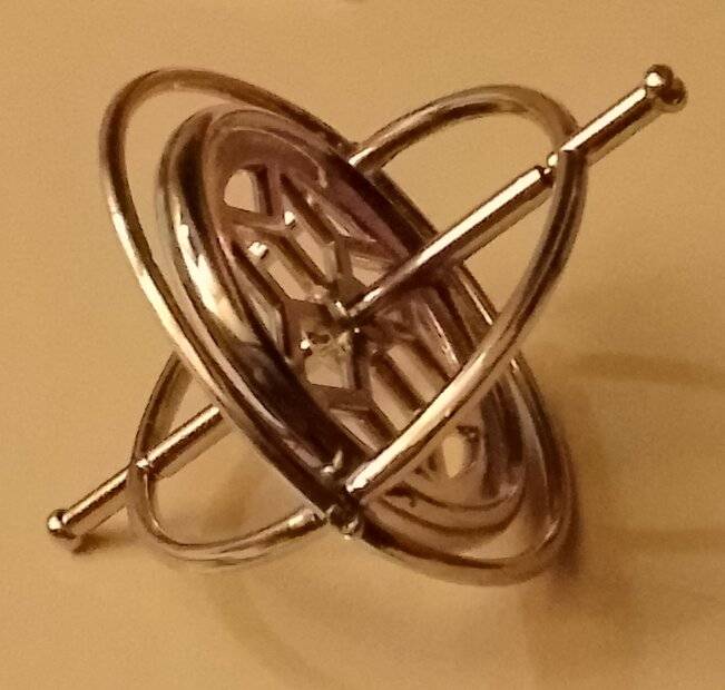

Yes, I am using this gyroscope and I am putting the end shown on the second photo directly on the surface with no support structure. I think I can calculate the distance it covers by calculating the precession of the top, because they move the same?

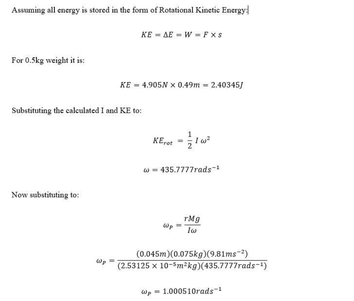

Hi to everyone reading this, I devised the following calculations. Could someone confirm if I understand the subject correctly and if my theoretically predicted angular precession velocity has a reasonable value? In the experiment I measured it to be twice as big. Can this be explained as KE decreasing due to friction etc. causing angular velocity to decrease and so angular precession velocity to increase?
You are assuming all the energy goes into ##\omega##, but as the gyroscope tilts over more and more of it goes into ##\omega_p##. Both that and frictional losses reduce ##\omega##, making ##\omega_p## larger.
Also, you originally asked for the minimum energy. How do you know your procedure achieves that? E.g., if you set the gyro horizontal to begin with, the higher the initial spin rate the slower the precession rate (and the higher the total energy).
My guess is that at minimum energy the two rotation rates would be the same order of magnitude. Did you do the analysis I proposed in post #14?
I did the analysis and I got Emin=0.052J at ω=26.26rad/s and ωp=16.6rad/s so they are as you said of the same order of magnitude. Correct me if I'm wrong: At the very first instant all energy goes to ω and then gradually transfers to ωp. I can make a video of the gyroscope spinning and manually record the times at which it's outer structure (namely the tip) completes the full rotation (2πrad). From that I can calculate how the precessional velocity changes overtime and compare it to the predicted value. If I initially set the gyro horizontally, will the minimal energy point be signified as the gyroscope falling off the support structure, i.e. below the horizontal? That would be convenient, because I would be able to calculate how much time it took for the gyroscope to lose it's energy.
