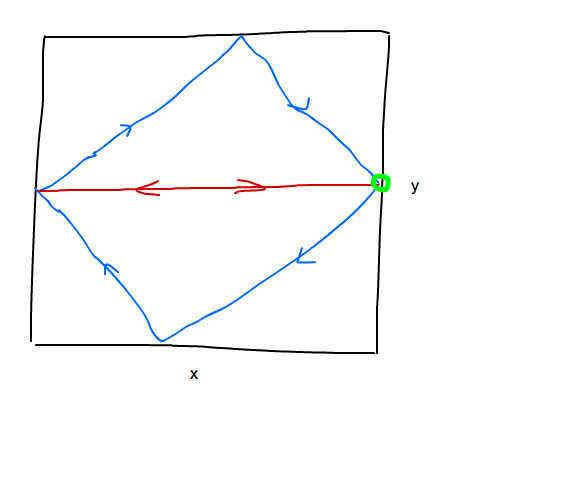

But it will not change how long it will take before it hits again the same wall which lies in the yz plane.
I made a drawing: the green molecule will take the same time to come back to that wall regardless of whether it takes the blue or the red path, provided that ##v_x## is the same.
