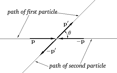

You're confusing two things. On a collision, both momentum and energy are conserved.
Let's consider a balloon full of gas. If the net momentum is to the right, then the whole balloon moves to the right. But if the balloon sits still, then the net momentum (meaning add them all up) of the gas particles inside is zero.
So, two particles can exchange momentum in a collision, but the net momentum change of the pair is zero.
(m1v1+m2v2)pre collision=(m1v1+m2v2)post_collision
Right. But the momenta of the two particles after the collision are correlated in the general sense, in that their momenta have become related by the collision - if I reverse the trajectories (i.e. I flip the signs of both of their momenta) of the two particles they will meet back at the collision point. That is, their momenta can be related even though the total net momentum is zero. (Or perhaps this is all only the case in non-equilibrium scenarios?)
