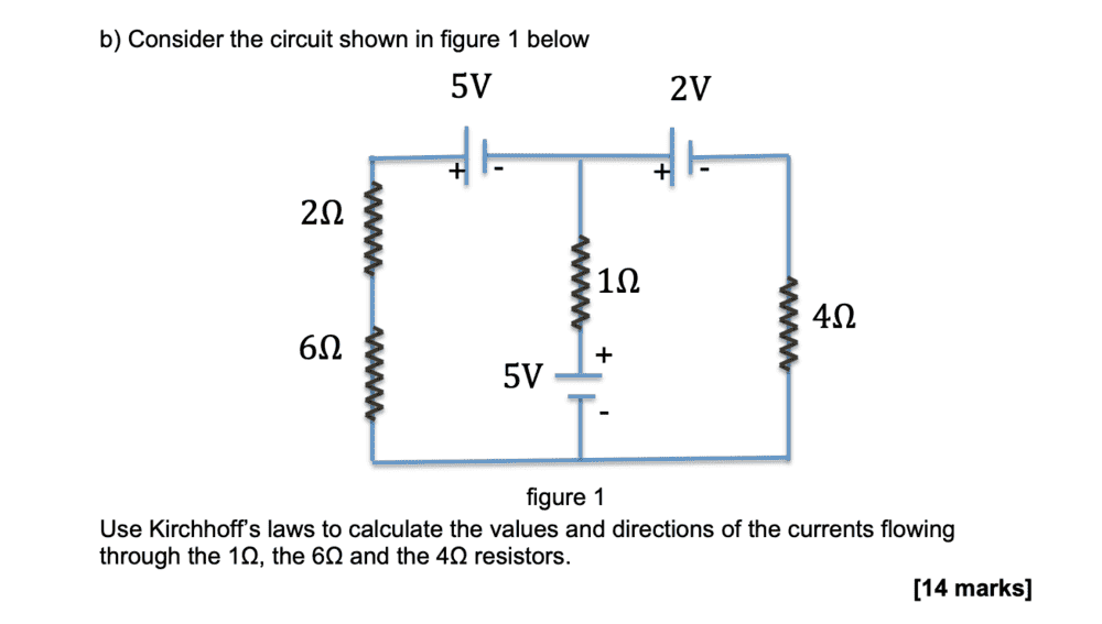

See image attached
Kirchhoff's 1st and 2nd law
Struggling to see if I am doing this right or not from a section of a question I have been given

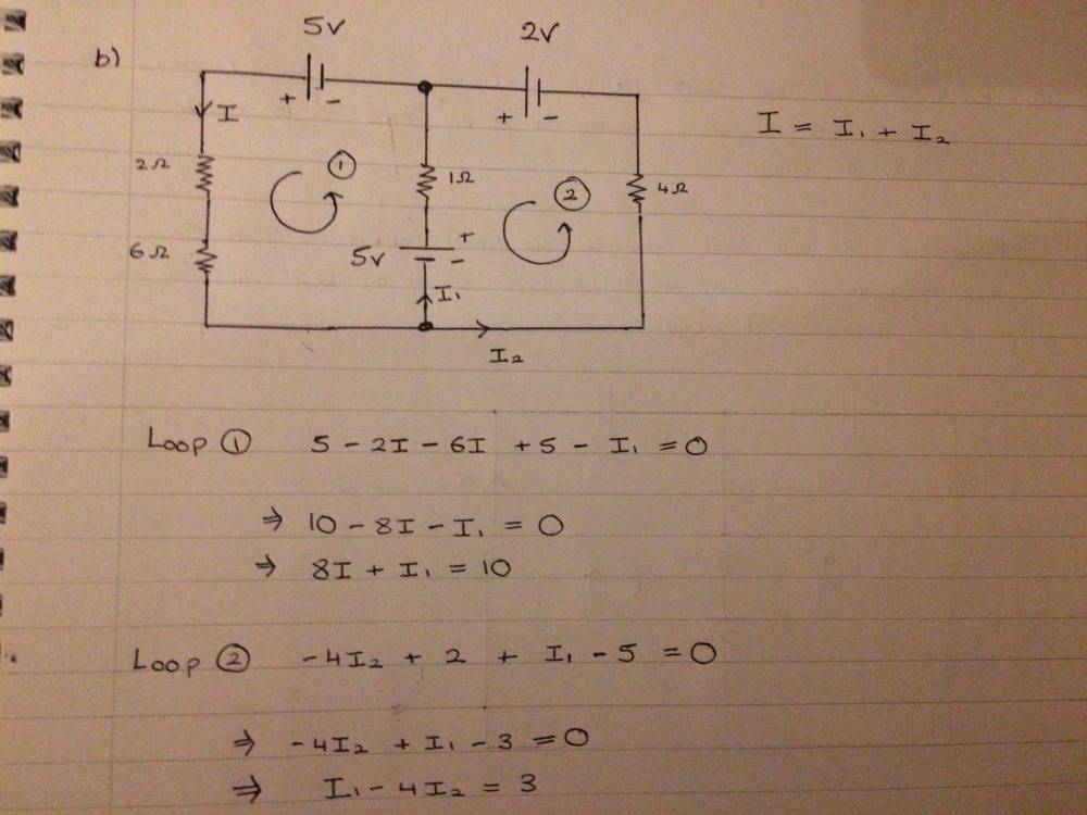

I have drawn out a sketch of the circuit again, and labelled as to what my 1st and 2nd closed loop to be to then apply Kirchhoff's 2nd law
I get a negative I_2 current which just indicates that my original assumption of the currents direction was wrong and it is in fact going the opposite way

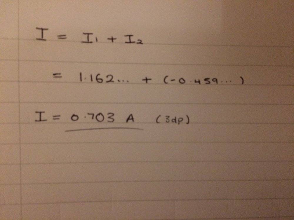

So I believe that the current going through:
6 ohm resistor = 0.703 A
1 ohm resistor = 1.162 A
4 ohm resistor = 0.459 A
Is this right or have I miserably gone wrong somewhere? :oldconfused:
Any help would be really appreciated! Thanks

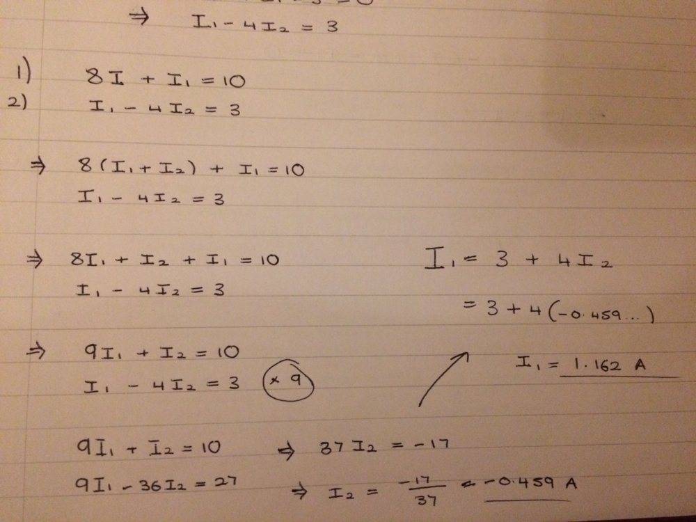

I followed through your workings and arrived at the same conclusion as you.
I found your error. It is in the step where you expand the parenthesis:
8(I1 + I2) + I1 = 10
Check how you expand the parenthesis and take care of the 8 coefficient.
Hi @Bolter I originally made the same error, and didn't catch your mistake. It was when I took those currents, plugged them back into the original circuit - I realized that the loop voltage drops did not sum to zero, so then started looking for an error.
Lesson: always go back and plug your answers into your original problem, as a check.

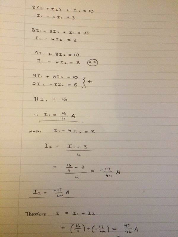

Thank you for catching in on my mistake :)
I have redone solving the simultaneous equations again using the corrections and I got these as my currents
So I can say that the current through:
6 ohm resistor = 47/44 A
1 ohm resistor = 16/11 A
4 ohm resistor = –17/44 A

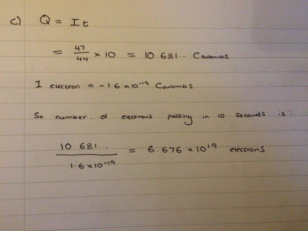

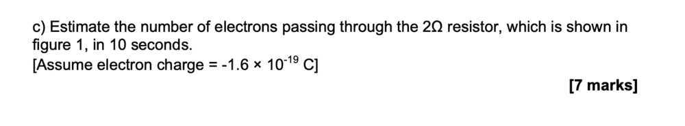

Is it also possible if you could help me out with part c) of this question?
I first worked out total charge that passes in 10 seconds, then divided that by the charge of a single electron to get total number of electrons in 10s?
