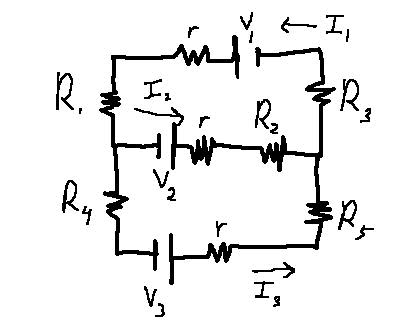

(a) Determine the currents I1, I2, I3 in the figure. Assume the internal resistance of each batter is r = 1.0 olms
(b) What is the terminal voltage of the 6.0 V battery?
I hope you can read my handwriting.
V = IR
I1 + I2 = I3
I don't understand kirchhoff's rules and how the internal resistance of each batter means.
First the way it's drawn it's I2 + I3 = I1
All it means is that charge has to go somewhere. ∑ I_in = ∑ I_out
Direction matters.
The little r's are the internal resistances of the batteries. When they ask for the terminal V of the 6v battery they want you to include the I3*r change in voltage from 6v that you would measure in real life.
To solve you need to write out the loop equations for the 2 inner loops. Those along with your current conservation give you 3 equations and you have 3 unknown currents. So then you just solve.
Okay, can you tell me if my loops are right?
Top: V1 + V2 = I1r + I1R1 + I2r + I2R2 + I1R3
Bottom: V3 + I2R2 + I2r = I1r + I3r + I3R5 + V2 + I3R4
Big: V1 + V3 = I1r + I1R1 + I3R4 + I3r + I3R5 + I1R4
First of all forget the Big loop. The 2 inner loops and the conservation of current is all you need.
The top and bottom look OK just glancing at them.
Now use
I1 = I2 + I3 and you can get it down to 2 equations and 2 unknowns pretty pronto.
Then solve.
Okay, so I figure out the currents. I'm still pretty confused with finding terminal voltage.
Are you saying that Terminal Voltage = I3r?
No. Terminal voltage is 6v + I3*r. (This is if that is the right direction for I3.)
