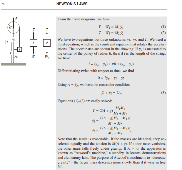

Hey, all. I am working through Kleppner/Kolenkow and encountered a problem when trying to follow the example pictured below. My issues comes when they say "Equations (1)-(3) are easily solved..."
As it turns out, they are not so easily solved for me! So, it appears I've found a hole in my mathematical training that needs to be filled (K&K have proved to be good at exposing these weak spots).
Textbook page titled Newton's Laws: diagram of an Atwood machine with pulley and masses labeled 1 and 2, followed by numbered equations (1) to (3) and the solved expressions for T and the accelerations.
All pictured above.
Frankly, I'm not sure where to begin. I've tried expanding the ##\ddot{y_1}## and ##\ddot{y_2}## terms using ##(3)##, but the equations quickly become quite long. I haven't had the time to really sit down and see if they eventually clean up nicely and give the desired result, but truth be told, I don't feel too confident going into this and would love some help.

First of all, you may have noticed that the xp in the figure should have been yp .
Solve Eq.(3) for either ##\ \ddot y_1\ ## or ##\ \ddot y_2\ .\ ## Plug the result into Eq (1) or (2).
etc.

I actually solved it right before you posted your advice (I solved it in the same way):
I solved Eq. (3) for ##\ddot {y_2}## and plugged that solution into Eq. (2). This gave [tex]T = W_2 + M_2 (2A - \ddot{y_1})[/tex]
I then set the right-hand sides of Eq. (1) and Eq. (2) together: [tex]W_1 + M_1 \ddot {y_1} = W_2 + M_2 \ddot {y_2}[/tex]
From here, it was just a matter for breaking down the ##W## terms into their corresponding ##M_ig## terms and rearranging:
[tex]M_1g+M_1 \ddot{y_1} = M_2g + 2A M_2 - M_2 \ddot {y_1}[/tex]
[tex]\ddot{y_1} =(2A+g) \frac {M_2 - M_1g}{M_1 + M_2}[/tex]
To solve for ##T##, I simply plugged this result into Eq. (1), and the desired result followed immediately.
