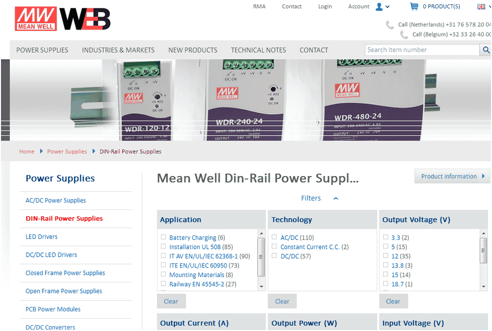

We use the MeanWell DIN Rail modular power supplies for applications like that. AC Mains input and a variety of output voltages and power levels (higher power versions are wider):
https://www.meanwell-web.com/en-gb/dinrail-powersupply/
Mean Well website screenshot of the DIN-Rail Power Supplies category page, with a product filter panel and model labels WDR-120-12, WDR-240-24 and WDR-480-24 visible on the devices shown.
  • Screenshot of the Mean Well WEB product category page for DIN-rail power supplies, showing product photos of WDR-120-12, WDR-240-24 and WDR-480-24 units and filter lists for application, technology and output voltage.
Those MeanWell supplies are switching supplies with fixed output voltage. The ripple specs show typically 1%p-p ripple with extrnal filtering of 0.1uF & 47uF in parallel.
