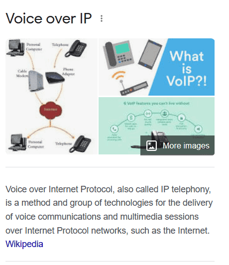

In the old days, people plugged landline phones into house/apartment wall mounted phone jacks. This was standard.
Then, at some point, people started plugging their landline phone cords (via an adapter) into their internet modems.
Dumb question for a non-techie. Why is that? Also:
a.) How is it possible for modems to give you phone service when it's an internet connection service to residences? Is it because you can use your internet provider (I use Verizon) to also purchase residential landline phone service too?
b.) Even if the above is true and you use the same internet and landline phone service provider, how does the modem itself let you make calls through a landline phone? I thought there was something special about those old school wall mounted phone jacks that required you to use them for old school phone service.
c.) If your internet and landline provider are different, can you still plug a landline phone into modem? Or, in that case, would the phone cord have to go into a phone wall jack.
d.) If you plug a landline phone into your modem, does that make it susceptible to someone over the internet hacking your phone and/or listening into your call somehow?
Thanks for your feedback.
Yes, they are provided 48Vdc power from the Central Office (CO) and transmit audio band waveforms to/from the connected CO.

Can you provide an example of a 48V POTS (plain old telephone service) phone jack on a modern Internet modem? I've never seen that.
My VOIP provider supplies a dedicated modem which connects to my LAN and allows connection of an otherwise unpowered old style "wall phone" which is part of my former interior phone service. So I assume it supplies the 48V. It in fact is connected to my two-wire house telephone wiring formerly used by AT@T with several connected phones.
Interesting. But when you say your VOIP provider, what is the physical connection to their CO? Fiber, cable, or DSL twisted pair?
And can you still dial a number with your classic POTS phone by clicking the hang-up buttons? I wonder if they included that feature...
