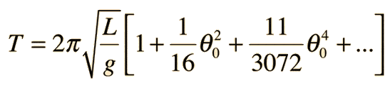

The equation for large-angle pendulum can be infinitely long. What is the pattern with the latter numbers in "..."?

Yeah, but what's the pattern that comes after 11/3072 (theta)^4?
There is no pattern. That's why you need the elliptic integrals.

I don't know the equation for generating those numbers in the formula but here is the large amplitude formula carried out to theta 20:
Honestly, I wouldn't be surprised if this a Taylor expansion of some sort.

. . . .or something else. There are (my Mathematician friends tell me) many equations that can only be solved using a series - Taylor or not so well known ones.
I originally was writing a pendulum calculator and while researching the Internet, I came across this topic. Anyway, I finished the calculator and it is online: http://www.1728.org/pendulum.htm
It can calculate pendulum periods up to theta 14 and uses the arithmetic mean to calculate exact pendulum periods.
Try it out if you like.
