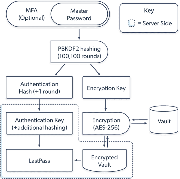

This link has a useful diagram illustrating what LastPass actually does: https://www.lastpass.com/security/what-if-lastpass-gets-hacked

Here's the diagram from that page:

sysprog said:
The way it was done with ACF2 in the '80s
That may describe how Amazon deals with passwords, but what does it have to do with LastPass?
ACF2, the Access Control Facility, is a mainframe data security product. In the diagram, in post #21, linked to by@pbuk on post #20, you can see that LastPass does PBKDF2 hashing, which is in principle like what ACF2 did in the '80s to do a one-way hashing function using a DES block cipher (nowadays, it uses XDES+proprietary). (ref: https://en.wikipedia.org/wiki/Cryptographic_hash_function)
Yes, but how does this matter? It's a fact, but not a relevant fact.
The key point is that LastPass can't leak a master password because they can't leak what they don't know.

I agree in re the "key point" -- the rest of what I said was to clarify the line of inquiry that I started in post #13.
