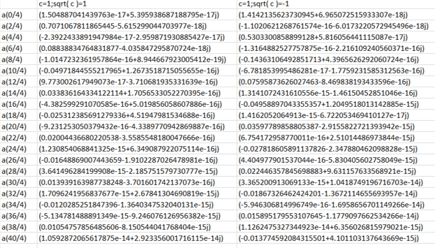

Hi all. I tried also today with the algebraic function sqrt(z+sqrt(z)) and it is still working.
1) i tried first the case in which the approximation is developed around 1. It approximated perfectly but it did not generated any fractional exponent (only taylor like terms). Perhaps it is because I worked with the branch in which sqrt(z)=1 but I am not sure. I have to check further just in case. It looks ok, but I'll keep on looking at it.
2) then i tried the case in which z=0. Here it only appeared terms with fractional exponents of the form (2n+1)/4, being n equal to 0 or natural numbers. In this case all the coefficients
were real and it approximated again perfectly the 4 values of this multivalued algebraic function.
Regards!

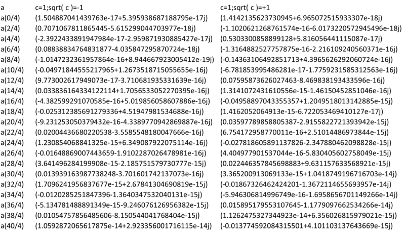

In fact, applying my Python code to the case above stated (sqrt(z+sqrt(z))), we arrive to results that clearly can´t be deduced by a collorary from taylor series. For example, when we work with an anulus of radius 0.5 and center c=1, we have that when the inner square root gives -1 as a result, then it sort of poses a branch point (because the whole result is zero). However, when the inner square root gives +1 as a result, then you can´t access to the other planes of the Riemann surface working with curves with radius<0.5. As a consequence, the python code is giving me two sets of parameters when I work with c=1 depending on wether we are in the branch in which the inner sqrt is +1 or -1:
Table of computed Laurent coefficients a(n/4) for n from 0 to 40, in two columns labeled c=1;sqrt(c)=-1 and c=1;sqrt(c)=+1, each entry a complex number with tiny real and imaginary parts.
As you can see, this method is giving taylor like exponents (non fractional exponents) when we are in the branch in with the inner sqrt is equal to 1) and not taylor like exponents (n/2 exponents) when we are in the other branch generated from the inner sqrt. I don´t see how a method based on replicating main branches with taylor series would be able to replicate in this manner.
Ps: In fact, for this case, the taylor method cannot be applied to the branch in which sqrt(c)=-1 because the derivatives goes to infinity
