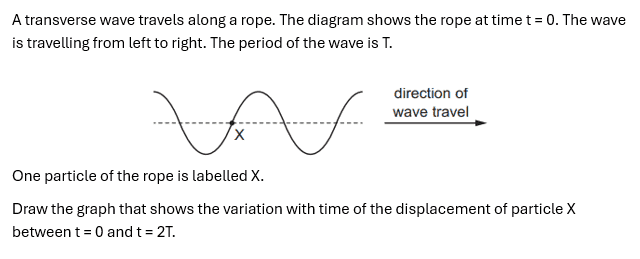

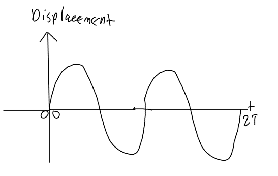

I have an assignment on the waves chapter and have been stuck on a question. Initially, I drew I drew it as attached because 4 pi meant the same thing as the original graph but I have been marked incorrect for this question. How would one solve this?

Try to relate your displacement of X with the motion of the wave. Is there anything wrong?

Isn't the particle going up and then down?

Just after t=0, has the particle gone up or down? How can you tell?

Hasn't it gone up because the curve is upwards?
Draw the shape of the wave a small time (less than half a period) after the original time. Which direction has x moved?
More mathematically, any wave moving to the left will be described by a function ##u(x,t) = f(x-vt)##. The motion of the rope at ##x## is given by the partial derivative at ##x## wrt ##t##.what is this derivative?

That's just a guess. You should draw the graph of the wave after a short time and see where X has moved to. Always calculate.

Like this? But it doesn't make sense. Why is the particle going down?

Because there is a trough approaching!

Imagine putting some colours on the wave. Red for a trough/minimum, blue for zero (x-axis) and green for a peak/maximum. The point at X would start blue. The next change would be to red. You can imagine that red trough coming in from the left heading towards X. The green colour (peak) has already gone and is moving away from X to the right.
In that snapshot of the wave, X has has its peak and is on the way down!

We can only draw a graph of ##y## as a function of ##x## at some fixed time ##t = T##, say. The wave itself is a continuous succession of graphs with ##x## and ##y## axes. Also, we can show the motion of a given point at ##x = X## as time varies. That would be a graph with ##t## and ##y## axes.
The reality is that a point on the second graph (##y(X, t)##) is increasing at a time ##t## where a peak is to the left of point ##X## in the first graph. And, ##y(X, t)## is descreasing at a time ##t## when a peak is to the right of ##X## in the first graph.
In general, you are trying to amalgamate the ##x-y## graph with the ##t-y## graph.
