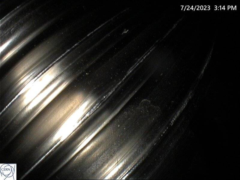

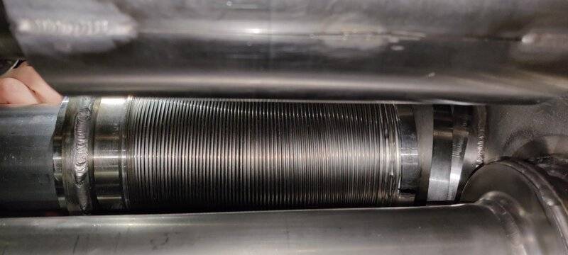

Here is the damaged bellows before being replaced. There was a crack in a weld only 1.6 mm in length. It is just about visible in the centre of the zoomed-in picture.
