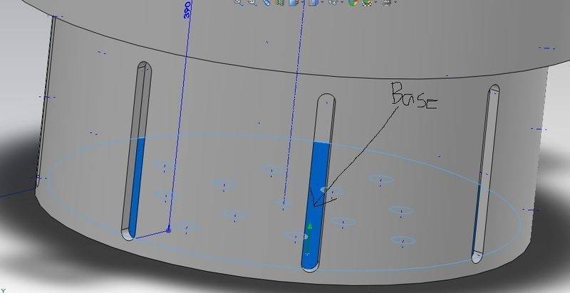

Hey basically I'm trying to find a light and small mechanism that is able to clamp up/fasten two board/plank together in a simple way without the use of screws. I'm trying to connect an acrylic board with the right suitable size on the base of the design. Do anyone have a thought on this? I have been searching through lots of catalogs but couldn't find anything right...

I'm sorry I don't understand your picture.
Do you mean you want to fix the blue strips to the curved surface of the grey cylinder?
If so
Can you fix permanent taper guides to the cylinder surface and taper the blue strips so that they can be driven home to a tight friction fit, yet be disassembleable?
You can obtain substantial fixing power with a very slight taper.
The blue strips is actually the base of the cylinder that i highlighted. I want a flat board(not in the picture) to be tighted and fastened on the base without the use of any scew and can be disassembled/taken out easily.
I still don't understand what you want to fix to what, however a taper or sprung plastic clip locked interlock could surely be fashioned.
How about a proper drawing?
It would be helpful to know the dimensions. How thick is that bottom plate?
What is the proplem with using screws?
Both Integral and Studiot raise a couple of good questions. The scale is quite important to what sort of device might be appropriate. While I quite like the diagram, I'm uncertain of something about it. It seems to indicate that the secondary floor plate is to go inside the cylinder, while your text explanation suggests that it is to be added to the outside.
If the former is correct, I'm thinking along the line of an "inside snap ring" sort of deal. Mill a groove around the cylinder and run a wire bead along it just above the inner plate.
