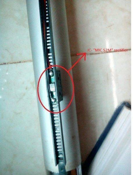

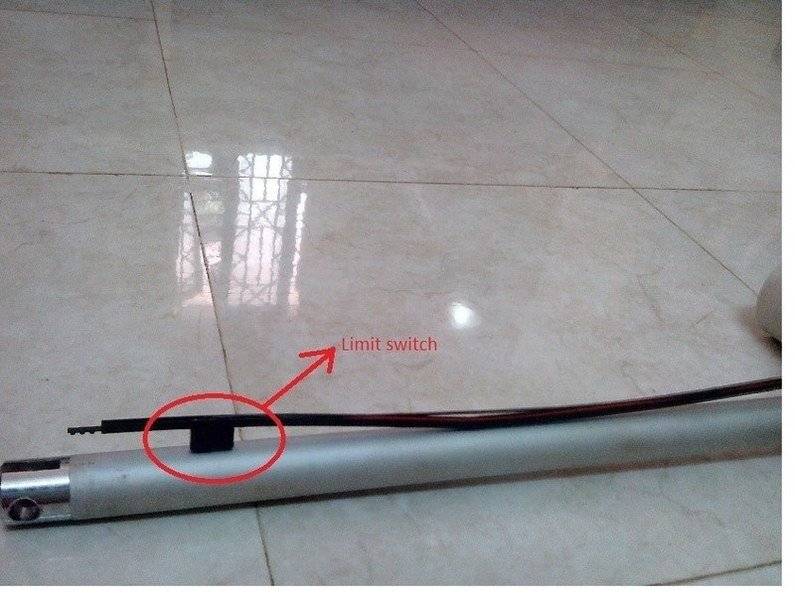

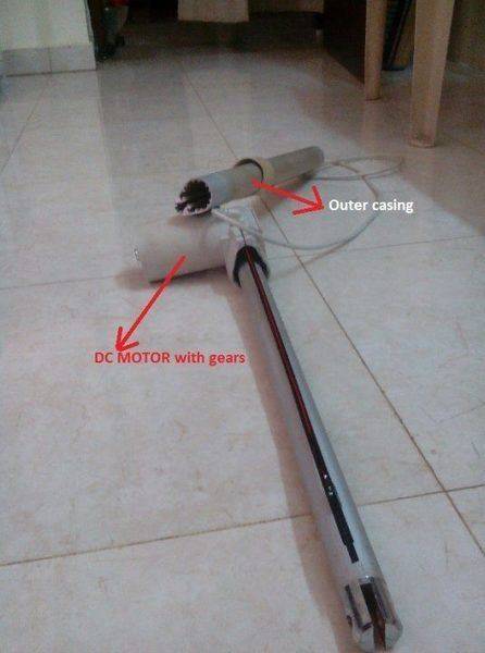

Apologies for the late reply. The motor no longer works. Hopefully its because some passive component got burnt-up. 1 good thing that seems to have emerged is that I have come closer to understanding the inner workings of the linear actuator. Please find attached the pics with descriptions of the parts inside the actuator.

  • Photo of a disassembled linear actuator lying on a tiled floor, showing an aluminium tube with a black plastic limit switch circled in red, labelled "Limit switch", and a black and red wire running along it.
  • Photo of a white linear actuator rail with a small green circuit board mounted on its side, circled in red, with a red arrow pointing to the red label reading "IC- "MIC S2M" rectifier".
  • Photo of a disassembled linear actuator on a tiled floor, with red annotations labelling a DC MOTOR with gears and the outer casing.
You might as well replace the Diode S2M at the same time. It is rated 1000 Volt, 2 Amp. Do the same for the other limit switch.

S2M implies surface mount? Then I'm thinking of using the 1N5408 as per the spec sheets. Yeah I see the smd diodes on top, numbers blackened out . Thanks for the tip.

It is highly probable that the motor was destroyed, the limit switch burned out due to the current surge when the motor failed.
You need to see if you can get the motor working on 12VDC before you start buying and fitting replacement parts. The power diodes are the least likely components to fail.
