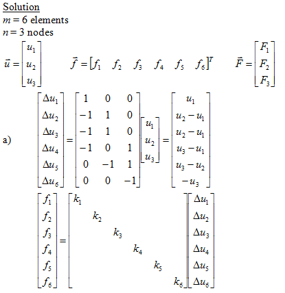

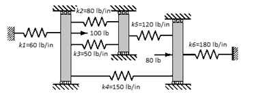

For the system of springs

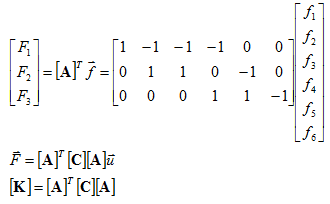

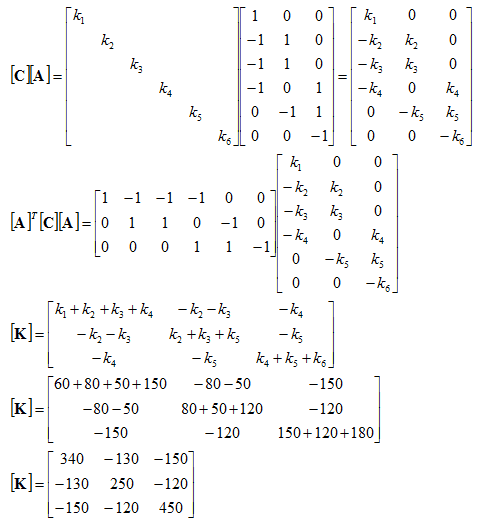

a) Assemble the stiffness matrix K and the force-displacement relations, K*u = f

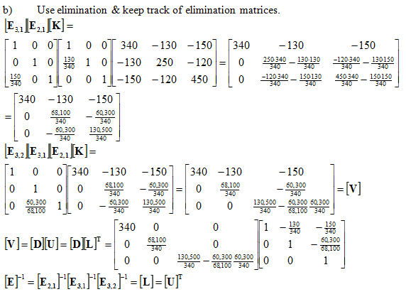

b) Find the L*D*L^T factorization of K. Use Matlab to solve

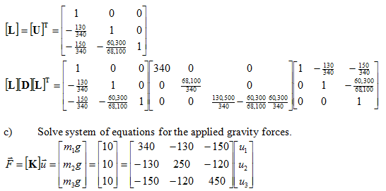

c) Use the boundary conditions and applied forces to find the displacements
I'm getting stuck on part c
My confusion lies in why is F = <10 10 10>^T? I don't see were these 10 values came from.
Thanks for any help!
Looks like a mistake since gravity isn't involved in this problem.
I think you might be right. I don't see how gravity is involved either.
