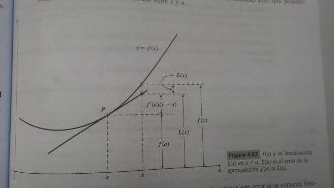

Hi, PF, want to know how can I go from a certain error formula for linearization I understand, to another I do not
Error formula for linearization I understand:
If ##f''(t)## exists for all ##t## in an interval containing ##a## and ##x##, then there exists some point ##s## between ##a## and ##x## such that the error ##E(x)=f(x)-L(x)## in the linear approximation ##f(x)\approx{L(x)=f(a)+f'(a)(x-a)}## satisfies
##E(x)=\dfrac{f''(s)}{2}(x-a)^2##
Quote I don't understand:
The error in the linearization of ##f(x)## about ##x=a## can be interpreted in terms of differentials (...) as follows: if ##\Delta x=dx=x-a##, then the change in ##f(x)## as we pass from ##x=a## to ##x=a+\Delta x## is ##f(a+\Delta x)-f(a)=\Delta y##, and the corresponding change in the linearization ##L(x)## is ##f'(a)(x-a)=f'(a)dx##, which is just the value at ##x=a## of the differential ##dy=f'(x)dx##. Thus,
##E(x)=\Delta y-dy##
The error ##E(x)## is small compared with ##\Delta x## as ##\Delta x## approaches 0, as seen in Figure.
Attempt to understand ##E(x)=\Delta y-dy##:
In any approximation, the error is defined by
error=true value-approximate value
If the linearization of ##f## about ##a## is used to approximate ##f(x)## near ##x=a##, that is,
then the error ##E(x)## in this approximation is
##E(x)=f(x)-L(x)=f(x)-f(a)-f'(a)(x-a)##
It is the vertical distance at ##x## between the graph of ##f## and the tangent line to that graph at ##x=a##, as shown in Figure. Observe that if ##x## is "near" ##a##, then ##E(x)## is small compared to the horizontal distance between ##x## and ##a##
##\displaystyle\lim_{\Delta x \to{0}}{\dfrac{\Delta y -dy}{\Delta x}}=\displaystyle\lim_{\Delta x \to{0}}{\left({\dfrac{\Delta y}{\Delta x}-\dfrac{dy}{dx}}\right)}=\dfrac{dy}{dx}-\dfrac{dy}{dx}=0##
Well, actually is a fake attempt: either of the limits tend to zero when ##\Delta x\rightarrow{0}##, but I'm confused by the premise of reasoning:
##\Delta x=dx=x-a##. Is there any explanation for a dummy like me? I fear the answer might need non standard analysis. But the premise sounds like "if apple=pear=apple".
Graph of a convex curve y = f(x) with tangent line at point P above x = a, marking E(x) as the vertical gap at x, with f(a), f'(a)(x - a), L(x) and f(x) labeled.

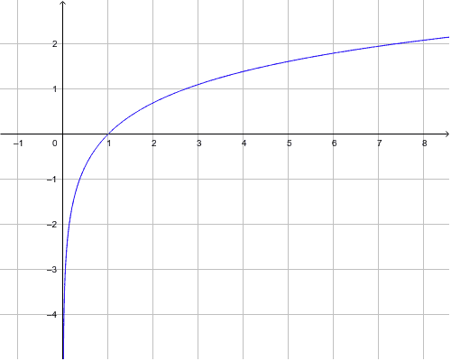

@Svein, I've been wondering...Well, I'm talking nonsense for sure, but this is what I've done: take ##y=\dfrac{1}{x}##, which is discontinous at ##x=0##; compute the first and the second integral with an online calculator, and now I think: ##g=x(\ln{(|x|-1)}## is not linearizable?. It is. But the second derivative is not continuous in ##\Bbb{R}##. I can't tell I must assume it. I apologize in advance.

mcastillo356 said:
compute the first and the second integral with an online calculator, and now I think: is not linearizable?. It is.
No. [itex]\ln(\vert x\vert )[/itex] does not exist at x=0 (in popular terms: it goes to -∞).
Graph of a logarithm curve in blue on a grid with labelled axes from -1 to 8 horizontally and -4 to 2 vertically; the curve rises steeply toward negative infinity as x approaches 0 and crosses the x-axis at x = 1.

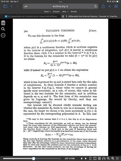

It seems the error term in post #1 is valid if only the second derivative exists, even if not continuous. See Courant, vol 1, p. 324, footnote, for example. This extends (and uses) the mean value theorem, where only the existence of the derivative is required. The continuity of the second derivative is apparently used to deduce the more precise integral form of the error term.
One consequence of this interesting property of the derivative is that it satisfies the intermediate value property even if not continuous. I.e. if the derivative of a function is negative at one point of an interval, and positive later, it implies that the function is not monotone, but changes direction, and a function that changes direction between two points must have a local extremum between them, hence the derivative, if it exists, must be zero there.
We often think intuitively of the intermediate value property as equivalent to continuity, but technically it is slightly weaker. This distinction is sometimes blurred in some less precise discussions, and in fact, continuity is (incorrectly to a mathematician) "defined" by this property on page 6 of the prelilminary section of volume one of Maxwell's Treatise on electricity and magnetism.
Sorry, I don't find the quote. Could you give me more details?

Here you go
Scanned page 324 from Courant's Differential and Integral Calculus, titled Taylor's Theorem, with printed formulas for the integral form and Lagrange and Cauchy remainder terms.
