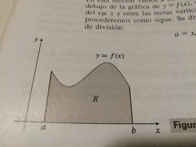

Trying to understand an introduction to the topic of the integral
Hi PF
There goes the quote:
The Basic Area Problem
In this section we are going to consider how to find the area of the region ##R## lying under the graph ##y=f(x)## of a nonnegative-valued, continous function ##f##, above the ##x##-axis and between the vertical lines ##x=a## and ##x=b##, where ##a<b##. (See Figure 5.4.) To accomplish this we proceed as follows. Divide the interval ##[a,b]## into ##n## subintervals by using division points:
$$a=x_0<x_1<x_2<x_3<\cdots<x_{n−1}<x_n=b$$
Denote by ##\Delta x_i## the length of the ##i##-th subinterval ##[x_{i−1},x_i]##:
$$\Delta x_i=x_i−x_{i−1},\qquad(i=1,2,3,...,n)$$

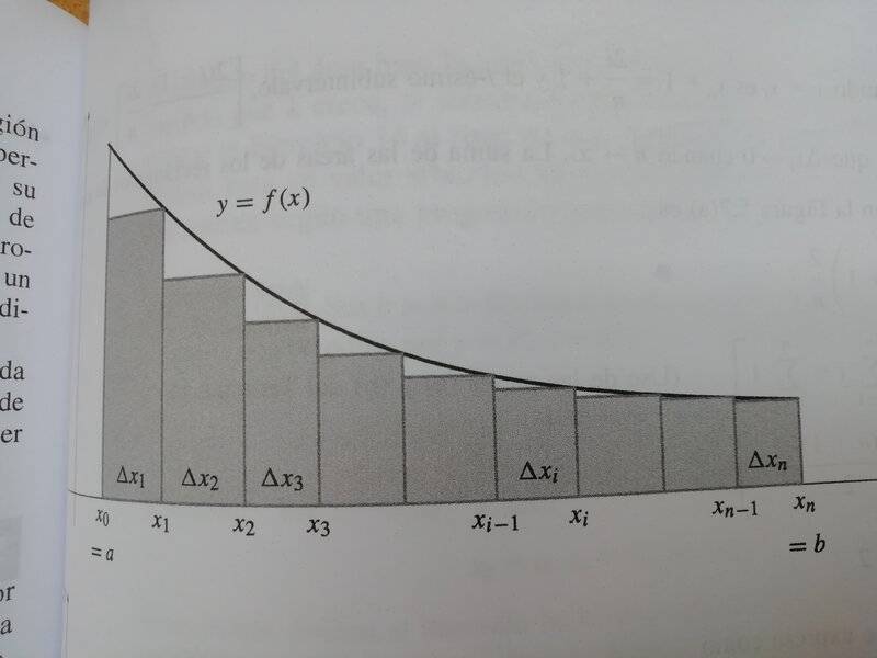

Vertically above each subinterval ##[x_{i−1},x_i]## build a rectangle whose base has length ##\Delta x_i## and whose height is ##f(x_i)##. The area of this rectangle is ##f(x_i)\Delta x_i##. Form the sum of these areas:
$$S_n=f(x_1)\Delta x_1+f(x_2)\Delta x_2+f(x_3)\Delta x_3+\cdots+f(x_n)\Delta x_n=\sum_{i=1}^n f(x_i)\Delta x_i$$
The rectangles are shown shaded in Figure 5.5 for a decreasing function ##f##. For an increasing function, the tops of the rectangles would lie above the graph of ##f## rather than below it. Evidently, ##S_n## is an approximation to the area of the region ##R##, and the approximation gets better as ##n## increases, provided we choose the points ##a=x_0<x_1<\cdots<x_n=b## in such a way that the width ##\Delta x_i## of the widest rectangle approaches zero.

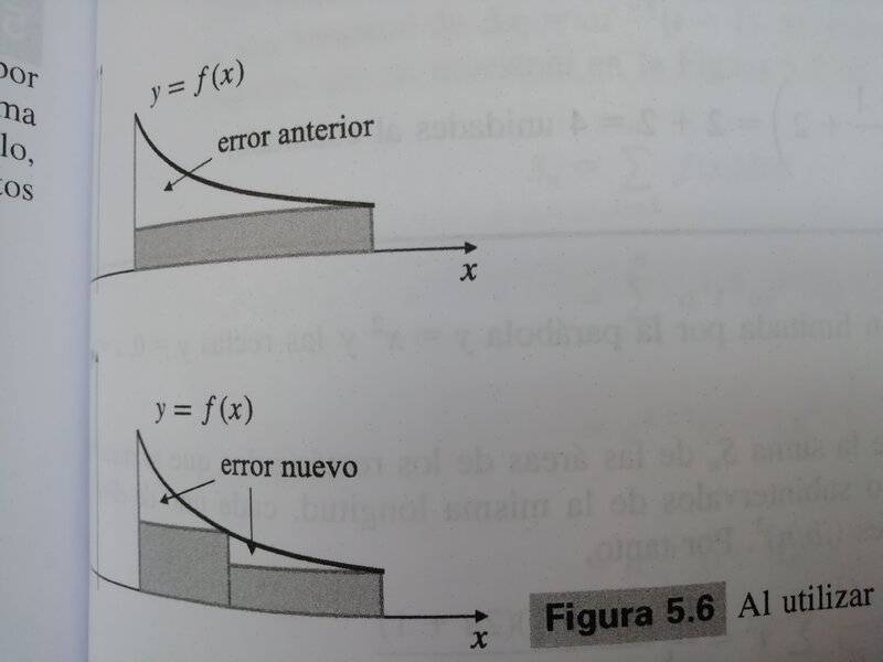

Observe in Figure 5.6, for example, that subdividing a subinterval into two smaller subintervals reduces the error in the approximation by reducing that part of the area under the curve that is not contained in the rectangles. It is reasonable, therefore, to calculate the area ##R## by finding the limit of ##S_n## as ##n\rightarrow{\infty}## with the restriction that the largest of the subinterval widths ##\Delta x_i## must approach zero:
$$\displaystyle\text{Area of} R=\underset{\max\Delta x_i\to 0}{\lim_{n\to\infty}} S_n$$
Sometimes, but not always, it is useful to choose the points ##x_i (0\leq i\leq n)## in ##[a,b]## in such a way that the subinterval lengths ##\Delta x_i## are equal. In this case we have
$$\Delta x_i=\Delta x=\displaystyle\frac{b-a}{n},\qquad x_i=a+i\Delta x=a+\displaystyle\frac{i}{n}(b-a)$$
Doubt, question
Only one. It's clear that this is a good introduction. States two facts:
(i) the more we subdivide an interval, the better will be the approximation;
(ii) we have to take limits. Here comes the doubt: we must take limit of ##S_n## as ##n\rightarrow{\infty}## with the restriction that the largest of the subinterval widths ##\Delta x_i## must approach zero. It's ok, but, why must we pick the widest subinterval?

To continue from what @anuttarasammyak said, if you had one subinterval that was, say, half the width of the whole interval, but you made all of the other subintervals smaller and smaller, that single large subinterval would prevent you from getting the true value of the area under the curve.
That's why it's necessary to stipulate that the largest of the subintervals must approach zero.

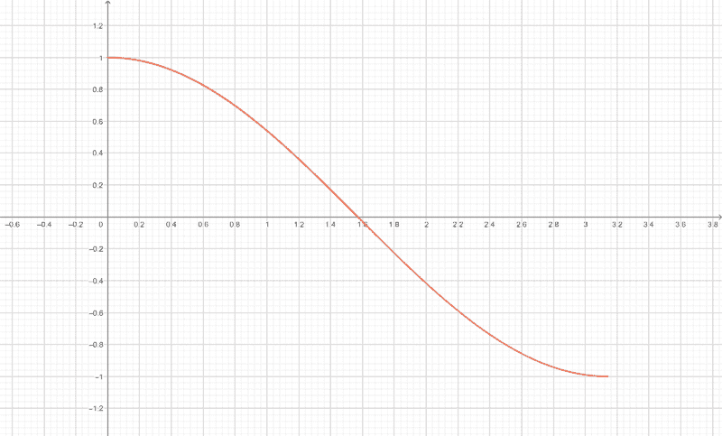

Hi, something like this?
It's cosine function, ##x\in{[0,\frac{\pi}{2}})\cup{(\frac{\pi}{2},\pi]}##
No. Your function is defined on two disjoint intervals, but is also defined at the point you don't include. What @Svein and I had in mind were functions that were discontinuous at endpoints of their subdomains.

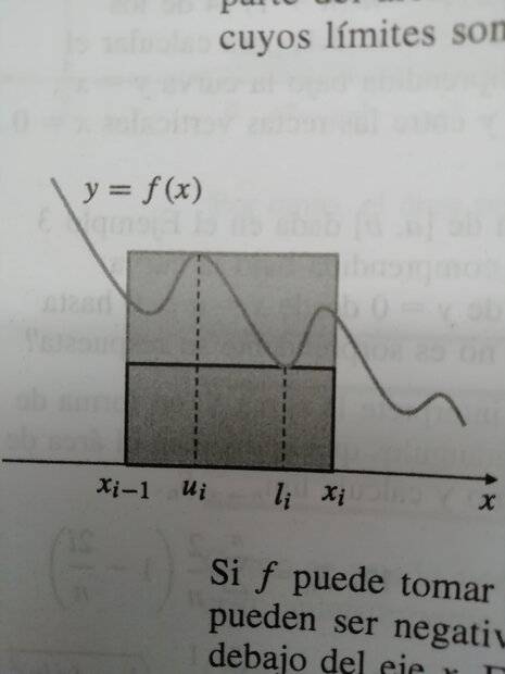

Hi, @Svein, were you intruducing Riemann Sums and Partitions? I've turned the page of the textbook, and I have stumbled upon something very similar to your quote, and I sense that more powerful for the calculation of areas (see attached figure):
If ##A_i## is that part of the area under ##y=f(x)## and above the ##x##-axis that lies in the vertical strip between ##x=x_{i-1}## and ##x=x_i##, then
$$f(l_i)\Delta x_i\leq {A_i}\leq{f(u_i)\Delta x_i} $$

If I can answer for Svein, that's the basic idea underlying the Riemann integral. In the limit as the number of subintervals increases without bound (again, assuming that the largest subinterval goes to zero), the lower Riemann sum and upper Riemann sum get closer together, trapping the value of the integral between them.

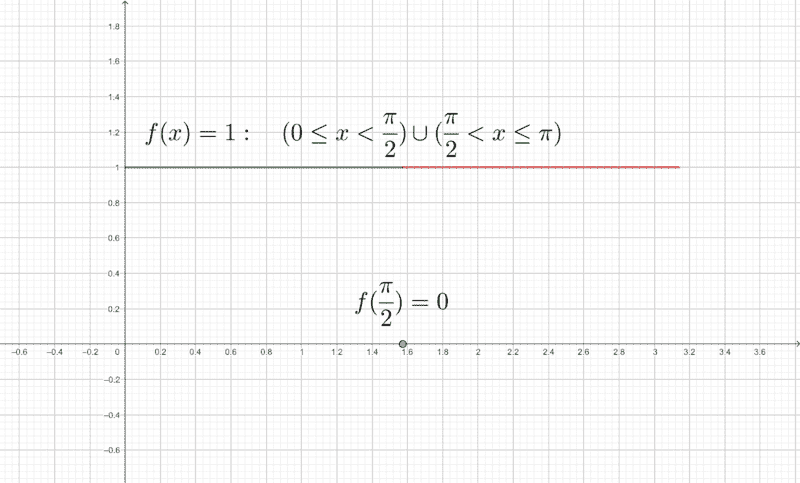

Is it anything like this image?
I think this is an avoidable discontinuity, but the the textbook only devotes a small review to it
Hi, dear PF
I need some advice, or better said, opinions. One of the functions suggested on post #10 was
$$f(x)=\begin{cases}{1}&\text{if}& x\in [0,\pi]-\{\pi/2\}\\0 & \text{if}& x=\pi/2\end{cases}$$
Now comes the controversy: if it is an avoidable discontinuity, it becomes a rectangle; And I have calculated the are expeditously:
$$\mbox{Area}=\mbox{basis}\times{\mbox{height}}=\pi\times{1}=\pi\mbox{ squared units}$$
Avoiding overthinking, or avoiding the spirit of this thread, this is, Riemann?
Regards

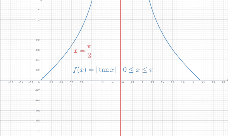

We usually say "removable discontinuity." With the function as you defined it, ##\int_0^{\pi} f(x)dx## does equal ##\pi##.
The other kind of discontinuity is exhibited with this function: ##f(x) = |\tan(x)|, x \in [0, \pi]##.

As noted above, the function you wrote has a removable discontinuity:
To evaluate the integral of this function you need to break up the interval into two improper integrals, and using limits at the discontinuity:
##\lim_{a \to \pi/2^-}\int_0^a 1 dx## and ##\lim_{b \to \pi/2^+}\int_b^\pi 1 dx##
Taking limits, we get ##\pi/2## for each integral, yielding ##\pi## for ##\int_0^\pi f(x)dx##.
In contrast, the function ##f(x) = |\tan(x)|## has a non-removable discontinuity in the interval ##[0, \pi]##. Using the technique I outlined above with improper integrals, neither integral converges to a finite number.

Not familiar to improper integrals. However, I understand what you explain.

Your post is exciting, comprehensible, and it suits my background perfectly. In essence, perfect for me, helpful.

They're dealt with in most calculus textbooks. Improper integrals typically are used when the integrand function isn't defined at one or both ends of the interval over which integration is being performed. Evaluating such an integral entails taking a limit, similar to what I did in my previous post.
