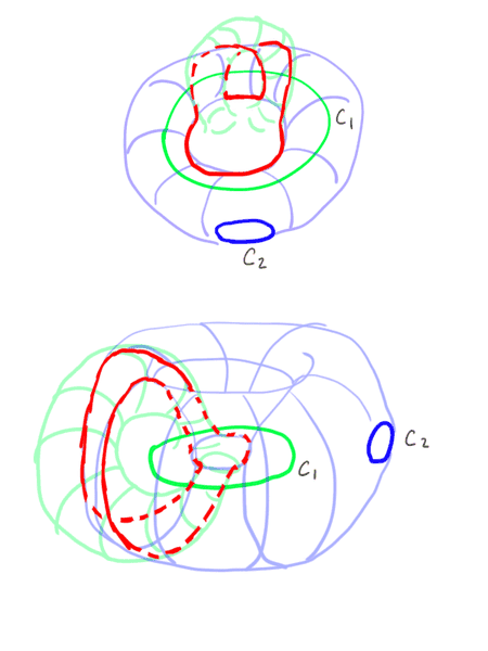

I think I found an example, if I've interpreted your post correctly. It's hard to describe, so I drew a picture. Hope it uploads properly. The curve C1 is in green, as is the manifold D1. The curve C2 and manifold D2 are in blue. The intersection is in red.
The surface D1 is non-orientable. I think this is the only way to get it to work. The red curve links C1 twice, basically interweaving a figure-8 on the circle.
D2 is a torus with a hole cut out, bounding C2. D1 is a Klein bottle with a hole cut out, bounding C1.

If you allow the surfaces to have self-intersections (but no intersection with either its own boundary, or the other surface's boundary), then I can find a solution with orientable surfaces. And with linking number 1 instead of 2.
