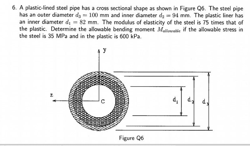

Having trouble figuring out how to link the two Young's Moduli to the Bending Moment, any suggestions?
thank, you! Trick seems to be converting the whole of the cross section into one material
Here is a copy of an exchange about a similar situation in another engineering forum.
In your case, there are only two materials to deal with.
See the attached file.
