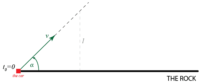

this is a rather simple high-school assignment a friend asked me to help him, but I got kinda confused, and I'm sure someone will clarify it for me real quick.
A car is moving away from a rock with the speed [itex]v[/itex] and with the angle [itex]\alpha[/itex] from the rock. At the moment when the distance between the car and the rock is [itex]l[/itex], the car emmits a short sound wave. The speed of sound in the air is u.
What's the distance crossed till the driver in the car hears an echo?
The attempt at a solution

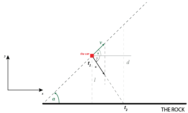

So the picture is something like this

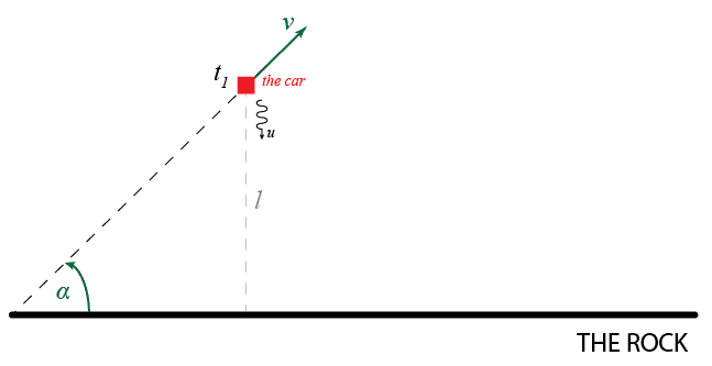

At moment [itex]t_{1} = \frac{l}{v \cdot sin(\alpha)}[/itex], the car will emit the sound wave with speed [itex]u[/itex]

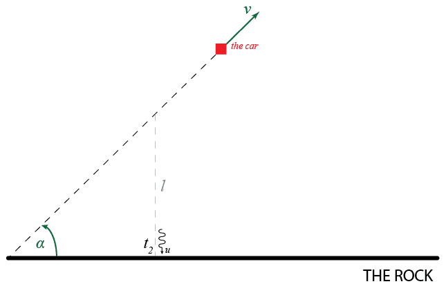

It will take [itex]\Delta t=\frac{l}{u}[/itex] more time for the sound wave to reach the rock, and by then the car will have crossed [itex]s = v \cdot t_{2}[/itex]
where [itex]t_{2} = t_{1} + \Delta t[/itex]
But I'm stuck here. How exactly does a sound wave echo? If it just bounces back, it will miss the car of course, so does it perhaps reflect in some radial form? If it does, how should I calculate the point there the sound and the trajectory of the car intersect?
Of course, I think we can assume that [itex]v << u[/itex], otherwise there wouldn't be any point to any of this. Also disregard that the magnitudes of the arrows (like velocity, for instance) are different in the different pictures, I did it to make the pictures more clearer.
Thanks in advance.

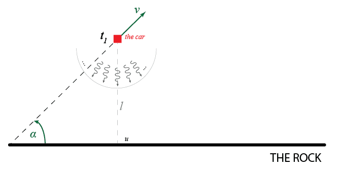

In that problem you should split all the [itex]v[/itex] into parallel and perpendicular to the rock line, that is horizontal and vertical.
The sound spreads from the car in a radial way, that is you should imagine the sound as a lot of particles departing from the car in all direction.
The rock reflects wave such as [itex]{v_x}' = v_x, \ {v_y}' = -v_y[/itex]
Hah, well that makes things only worse :D
How the hell am I supposed to pick which of all these possible rays is going to hit the car after bouncing? I suspect I am supposed to compare parallel and perpendicular components of [itex]v[/itex] with something, but I'm not sure with what.
I'm even more stuck now, but thanks nonetheless :D
Okay, I have an idea, so if someone could confirm it or refute it, it would be great
Basically, I'm looking for an angle [itex]\gamma[/itex] such that parallel components are equal.
[itex]v_{x} = v \cdot cos(\alpha) = u_{x} = u \cdot cos(\gamma)[/itex]
Under that condition, it will take [itex]\Delta t = \frac{l}{u \cdot sin(\gamma)}[/itex] time units for that particular sound wave to reach the rock. After that, I'm just comparing perpendicular components
[itex]d + v \cdot sin(\alpha) \cdot t_{x} = u \cdot sin(\gamma) \cdot t_{x}[/itex], where [itex]d = v \cdot sin(\alpha) \cdot t_{2}[/itex] ( where [itex]t_{2} = t_{1} + \Delta t[/itex])
After I find [itex]t_{x}[/itex], I just calculate the distance as [itex]s = v \cdot (t_{2} + t_{x})[/itex].
I realize my notation sucks and that there is perhaps some redundancy in the expressions above, but I did all that for a few minutes, so you'll forgive me.
What do you think guys?

Audio propagates as a circular wave.
When it hits the wall, at each point a new circular wave is generated.
Those generated waves superpose into a circular wave with a center that is symmetrically on the other side of the wall.
Here are a couple of example images:
[URL]http://www.phy.ntnu.edu.tw/ntnujava/snapshotejs/wave_reflection_2_20090117112315.gif[/URL]
[PLAIN]http://www.lightandmatter.com/html_books/0sn/ch06/figs/circular-reflection-upright.jpg
Cheers! :smile:

Your method looks good, but I'm having a bit of trouble understanding what you mean with your symbols and how they match your drawing.
I think your equations are not entirely right, but I'm not sure yet.
Hm, yeah, I guess I make notations in mysterious ways, not a good habit of mine.
Diagram can be identified as an x-y plane, and t_1 and t_2, for example, are parameters on those pictures, they're don't represent points or anything like that, more like comments, as in "t_1 is a time moment where the guy in the car emitted a sound impulse so I wrote t_1 on a diagram there".
Dashed curves are trajectories (with the exception of l and d, those are just distances, I probably should've used different types of lines for them).
If you do find an error, please let me know, and thanks for those pictures and an explanation!

Actually, I was wondering what you meant with [itex]d[/itex] and with [itex]t_x[/itex].
As you have drawn [itex]d[/itex] it seems to be the same as [itex]l[/itex], but that can not have been your intent.
And you introduced [itex]t_x[/itex], but you did not specify what it is.
In your drawing I would expect another line from the rock to the car at the point where the echoed sound reaches the car.
The angle of this line would be the same as the angle of the line between [itex]t_1[/itex] and [itex]t_2[/itex].
It seems logical to say that this would be at a time [itex]t_3[/itex].I haven't checked the formula of Quinzio, but I suppose you'd be interested in how to solve this problem yourself. Or don't you?Btw, I have to say that this doesn't seem like a problem that would be asked in high school!

Actually, I was wondering what you meant with d and with tx.
As you have drawn d it seems to be the same as l, but that can not have been your intent.
And you introduced tx, but you did not specify what it is.
The angle of this line would be the same as the angle of the line between t1 and t2.
It seems logical to say that this would be at a time t3.
By [itex]d[/itex] I meant the normal distance from the rock to the car in [itex]t_2[/itex], just like [itex]l[/itex] is a distance from the rock to the car in [itex]t_1[/itex]. By [itex]t_{x}[/itex] I meant [itex]t - t_2[/itex], where [itex]t[/itex] corresponds to your [itex]t_{total}[/itex]
But then I realized I didn't really need [itex]d[/itex] nor [itex]t_{x}[/itex] for the formulas, so they were actually unnecessary.
And you're absolutely right, it would've been most sensible to draw the intersection of the trajectory of the car and the wave and mark that [itex]t_3[/itex], thus complete the whole picture. If I remember correctly, I shut down the Illustrator and then realized this, but I was too lazy to turn it on and draw everything again, because I didn't save the picture prior to shutting down the Illustrator the first time, because I'm an idiot. :D
And yeah, of course I'm interested, his formula is a thing of beauty, would love to get it myself, but I ain't doing very well for now.

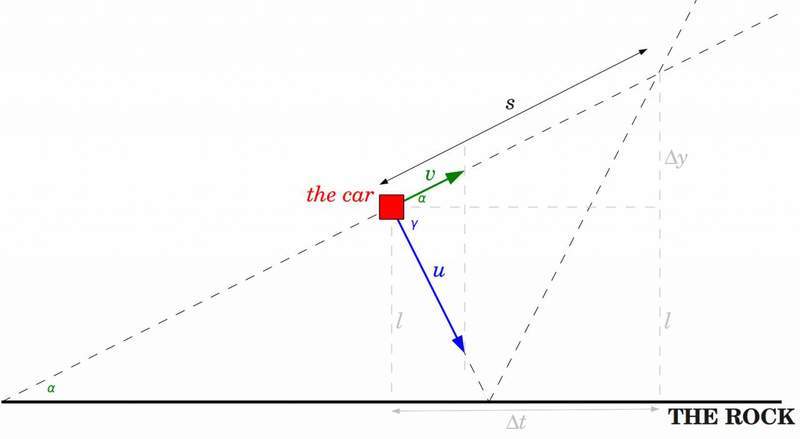

Well, I'll postpone going through your calculations.
I prefer to first have a proper drawing (and you make very nice ones! :smile:).
I'm sorry seeing you lost your previous efforts, so I made one of my own instead.
Then to define the proper symbols to use, which are shown in the drawing.
It doesn't matter if there are more than necessary.
Then to define the proper equations, preferably numbered.
And finally solve those equations for the distance traveled which the problem asks for.
I've been so free to use slightly different symbols.
Do you like my drawing? :shy:
Oh, I love your drawing Serena! Very clean indeed, thanks very much for that!
It helped me to understand the issue underlying here, I believe. The drawing of [itex]s[/itex] was the key, because I perceived the wanted [itex]s[/itex] as the distance from the very beginning till the moment the car and the wave intersect (the distance the car made for [itex]t_1 + \Delta t[/itex]), and Quinzio, for instance, perceived it as the distance from the moment the sound was made till the moment the car and the wave intersect (the distance the car made for [itex]\Delta t[/itex]). Dunno what is the desired distance out of these two in the assignment, but that's secondary to me right now.
So the system of the equations is the following (using your picture):
[itex]v_{x} = v \cdot cos(\alpha) = u_{x} = u \cdot cos(\gamma)[/itex] (1)
[itex]t_1 = \frac{l}{v \cdot sin \, \alpha}[/itex] (2)
[itex]\Delta t = \frac{l}{u \cdot sin \, \gamma} + \frac{l + \Delta y}{u \cdot sin \, \gamma} = \frac{2l + \Delta y}{u \cdot sin \, \gamma}[/itex] (3)
[itex]\Delta y = v \cdot sin \, \alpha \Delta t)[/itex] (4)
Inserting (4) into (3) we get
[itex]\Delta t = \frac{2l + v \cdot sin \, \alpha \Delta t}{u \cdot sin \, \gamma}[/itex]
[itex]=> 2l + v \cdot sin \, \alpha \Delta t - u \cdot sin \, \gamma \Delta t = 0[/itex]
[itex]=> \Delta t = \frac{2l}{u \cdot sin \, \gamma - v \cdot sin \, \alpha}[/itex]
Now, if we define [itex]s = v \cdot \Delta t[/itex], we get Quinzio's result, and if we define [itex]s = v \cdot (t_1 + \Delta t)[/itex], we get mine, yay! (with the final substition: [itex]u \cdot sin \, \gamma = \sqrt{u^2 - v^2 \, cos^2 \alpha}[/itex], that is)
Looks so simple now :D

Well, correct me if I'm wrong, but I think that's it. Once again, that drawing saved the day, nice job!
Thank you very much, both of you guys :)
