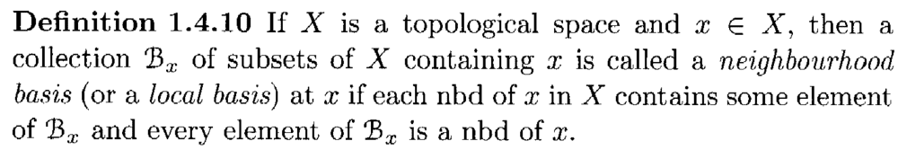

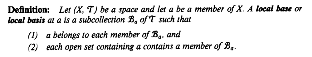

I need help in order to investigate two apparently different definitions of a local basis in a topological space ...
Fred H. Croom (Principles of Topology) and Tej Bahadur Singh (Elements of Topology) define local basis (apparently) slightly differently ...
Croom's definition reads as follows:
... and Singh's definition reads as follows:
The two definitions appear different ... ...
Croom requires that each open set containing a contains a member of ##\mathcal{B}_a## ...
... while Singh requires each nbd of x to contain some element of a member of ##\mathcal{B}_x## ... and one notes that the open set (necessarily) contained in the nbd would necessarily intersect with a member of ##\mathcal{B}_x## ... it would not necessarily contain the member of ##\mathcal{B}_x## ... so I see the definitions as different ...
Is that correct?
If the definitions are indeed different ... which is the more common definition ...?
Further ... are their significant implications for further theory built on these definitions ...?Help will be much appreciated ... ...

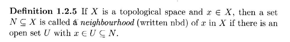

Peter=======================================================================================It may help Physics Forums readers of the above post to have access to Singh's definitions of a neighborhood (nbd) ...
... so I am providing the same ... as follows:
Hope that helps ...

Math_QED said:
Given the definition the OP gave, they are not. ##[-1,1]## is a neighborhood of ##0## in the usual topology but not open.
Oops, I haven't read as far.
However, Peter (@Math Amateur), this doesn't change the basic idea. I know neighborhoods as open sets, but of course they can likewise be defined as sets which contain an open set (plus the point they are neighboring). Just pass to this open set instead, let's call it open neighborhood##^* \subseteq## neighborhood.
This a small technical difference, not a basic one.

The definitions are formally different:
In the first definition we have ##a \in B_a \subseteq O## all open.
In the second definition we have ## x \in U_1 = nbd_1^* \subseteq B_x \subseteq nbd_2## where ##nbd_2## implies there is another open set ##x\in U_2 \subseteq nbd_2##.
They are technically the same thing, such as if you start natural numbers at ##1## or ##0##. It only makes things more complicated, if you allow neighborhoods or basis sets to be not open. All of them have a smaller open set within. The first definition directly uses these smaller open sets, the second one only makes things less obvious.
The advantage of the second one is, that you don't have to care about openness when it isn't needed. But I doubt that this weighs heavier than the clarity of the first definition. It's like: some authors automatically mean ##1\in R## if they speak of a ring, others don't.
Edit: There is one major difference I just recognized. Whereas in definition 1 the basis sets have to be within an open set, there is not necessarily an open set between a basis set and a neighborhood in definition 2. The open set ##U_2## which is required in definition 2 doesn't need to contain ##B_x##.
I would call the first definition local basis (open sets) and the second neighborhood basis just to distinguish them - keeping in mind that neighborhoods here don't have to be open, they only need to contain an open set.

Suppose we have a nbh system ##\mathcal{B}_x=\{B_i:i\in I\}## as in Singh's definition.
Given ##V_i\in \mathcal{B_x}##, let ##W_i## be an open set with ##x\in W_i\subseteq V_i##. We show that ##\{W_i:i\in I\}## is a collection as in Croom' definition.
First note that by construction all sets in our new collection are open and contain ##x##.
Let ##O## be an open containing ##x##. In particular, ##O## is a nbh of ##x## and by Singh's definition, there is ##i\in I## with ##V_i\subseteq O##. But then ##W_i\subseteq O## as well, so ##\{W_i:i\in I\}## satisfies Croom's definition.
Maybe I'm missing something? What do you think?
