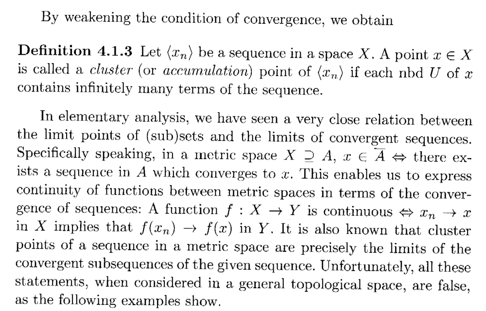

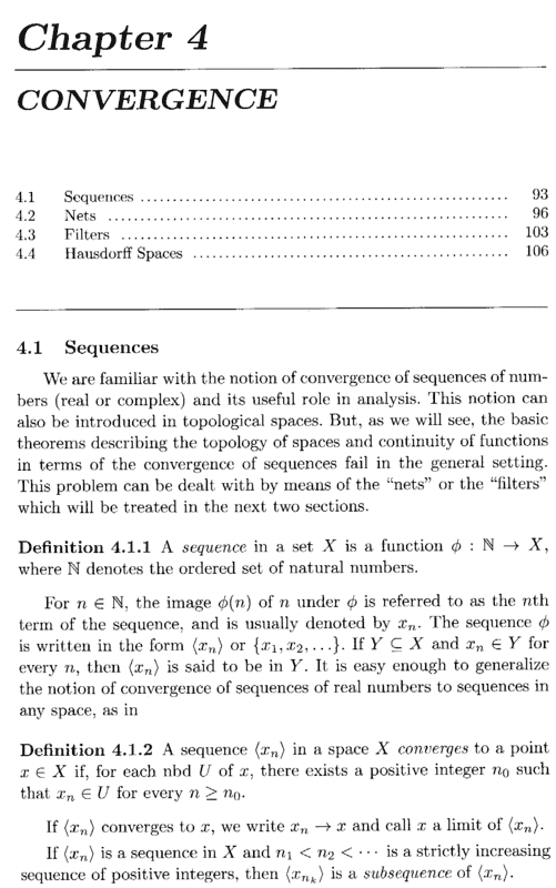

Peter=====================================================================================It may help readers of the above post to have access to Singh's definition of a neighborhood and to the start of Chapter 4 (which gives the relevant definitions) ... so I am providing the text as follows:
Hope that helps ...
Peter
