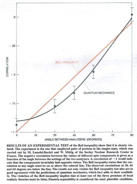

So knowledge about theta (β-α) is not applicable for the model testing QM predictions. Only a computer simulation for all thetas..
Graph of correlation against angle between analyzers in degrees (0 to 90), showing the Bell inequality straight line and a curved quantum mechanics prediction with experimental data points and error bars.

The thing is, as PeterDonis mentioned, this is exactly what has been looked at many times before. Bell's Theorem precludes this from working. You only need to check it for 3 pairs of angles to see the problem:
0/120 degrees
120/240 degrees
0/240 degrees
Try hand inserting actual values for these 3 angles 0/120/240 for a series of trials (it is easier if you work with the correlated case rather than the anti-correlated case). These cannot have pairwise values that match (or mismatch depending on setup) less than 1/3 (unless you know in advance which pair you are going to choose). QM predicts 1/4. This more or less corresponds to the graph you provided for the 30 degrees and 60 degrees cases.
When you hand insert values - that's so you can cherry pick to try and make it work out - you realize quickly that you can only make things work out if you cheat. I.e.you know which pair of angles you are selecting in advance. And if you cheat like that, you can make any formula work out. Even the QM prediction. :smile:

And that is not possible. Bells theorem basically says that if the results are encoded during preparation, then the correlations must obey the inequality. And as @DrChinese has repeatedly pointed out, you should try finding an encoding that leads to a violation of the inequality for just three angles (##0##,##2\pi/3##, ##4\pi/3##); you won't be able to.

You can do that, but the resulting table will not have the property that when the two angles are the same, the results of the two measurement are never the same. Thus, it fails to match observation even before we consider any inequalities.
