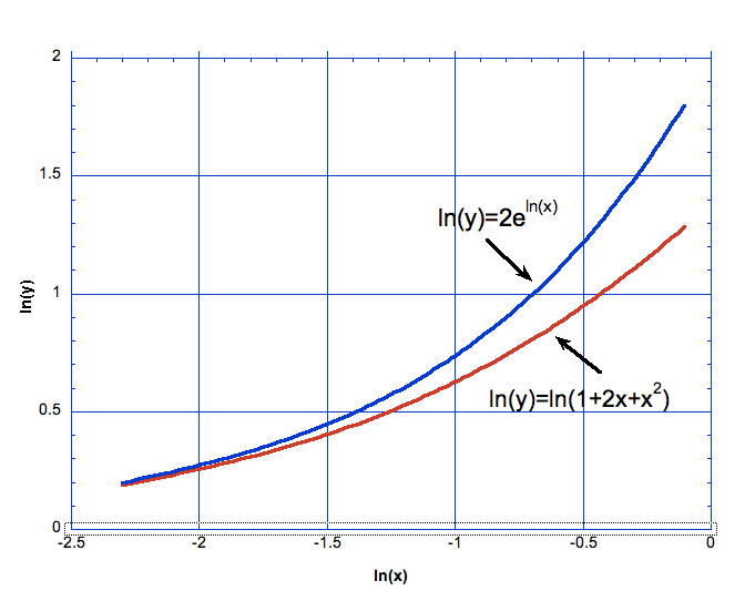

Sure you do. The asymptote I'm referring to is $$\ln{y}=2e^{\ln{x}}$$It's not linear or as simple as ##\ln{y}=0##, but it's much more accurate for x < 1 (and not too difficult to plot).

There is a second asymptote as x tends to 0 that provides a much closer approximation to the desired function than simply ln(y)=0. That asymptote is $$\ln{y}=2e^{\ln{x}}$$. Plot it up and see what you get in comparison to the desired function.
Both functions in the relevant range. I don't see the point.
ln(y)=0 is an asymptote, a nice straight line that provides an excellent approximation for small x. What you suggest is an arbitrary function that is not a straight line and not the full function either.
