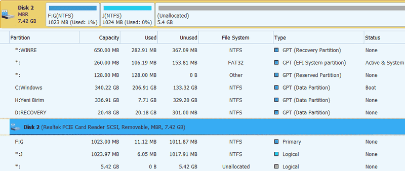

Would you please check and explain what is wrong?
Disk management screenshot of Disk 2, a 7.42 GB removable MBR disk, showing partitions F:G (NTFS, 1023 MB) and J (NTFS, 1024 MB) and 5.4 GB unallocated space, with a partition table listing capacity, used, unused, file system and type.
I cannot see J even though it has been formatted.

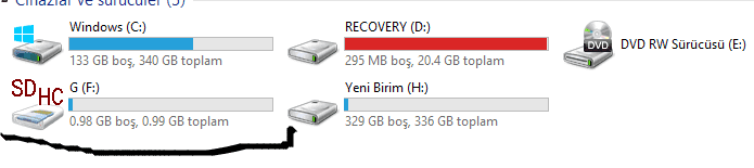

Windows File Explorer showing drives under Devices and drives: Windows (C:) 133 GB free of 340 GB, RECOVERY (D:) 295 MB free of 20.4 GB, DVD RW drive (E:), SDHC card G (F:) 0.98 GB free of 0.99 GB, and Yeni Birim (H:) 329 GB free of 336 GB.
I can only see F. What configurations should I choose to make disk divided into partitions?

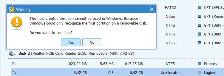

What is wrong I am doing to create a partition? When I try I take this notification
Windows warning dialog stating the new partition cannot be used in Windows because only the first partition on a removable disk is recognized, with Yes and No buttons, over a disk management list showing Disk 2 as removable with an unallocated 6.42 GB logical area.
I searched for that notification but I didn't find a good explanation for my case.

It seems clear. It says the a Windows limitation prevents the recognition of multiple partitions in a removable disk. Is this related to your other posts about making backups of an SD card?

We all understand you want to talk about partitions here but you are asking about using them for some sort of DIY backup scheme. We don't want to encourage you to do something that is illogical.
That said Windows does not support the thing you want to do. Kludging together a system level thing that the OS doesn't really want to do is asking for trouble. Even if you get it to work it may fail catastrophically after some future system update.
