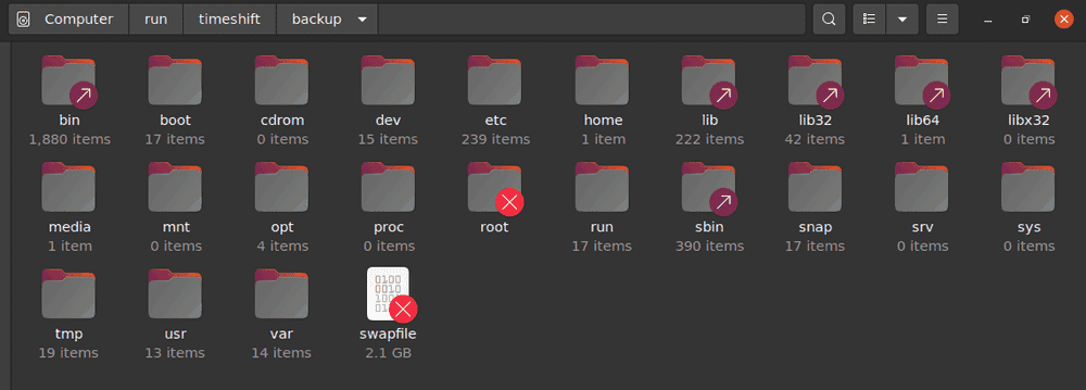

I learned about timeshift in the Linux Mint blog, and then read from It's FOSS that the utility not only backs up data, but can restore the OS with all its settings and customizations. I installed timeshift following the instructions from the latter website. Upon starting it, it asked me for the password, which I gave. Then it started showing some customizations. I choose rsync, but then I decided that I will do it later, so I exited the software at that point of time.
Now, I found that there is a new directory: /run/timeshift/backup that is almost a copy of the root directory, including my home directory:
It's size, returned by sudo du -sh, is 320 GB. Too much.
I reopened timeshift and opened its logs. In the first log file, I found this:
Code:
[22:24:51] Snapshot device: '/dev/sda2'
[22:24:51] Snapshot location: /run/timeshift/backup
Note that I have not created any snapshot yet.
Given the above data, is it okay if I delete this folder using sudo rm -rf /run/timeshift/backup?

I believe this folder is not just a "simple" folder. I have removed timeshift for the time being using sudo apt remove --purge --autoremove timeshift. I created a sample text file in my home directory, and that file "magically" appeared in /run/timeshift/backup. When I deleted the file from the latter directory, it got deleted from my home directory too! Therefore, deleting this directory is not safe. Also, a few days back, I remember seeing in the System monitor that my hard disk had around 590 GB space left. Currently, it is 589 GB. It means that /run/timeshift/backup is actually not taking up any space. It is somewhat like a shortcut that we have in Windows.
Shortcuts in linux are made with either hard links or soft links. Learn more about them here.

Nope, this is not how we got here. Let me reiterate what I did.
  1. I installed the program.
  2. Clicked on the software icon from the launcher.
  3. It asked me for my password, which I gave. (Other websites indicate this is safe.)
  4. The software started, and asked me to choose between RSYNC and BTRFS. I chose the former.
  5. The software initialized itself, and opened up the main window where snapshots would be listed. It was empty.
  6. I discovered the /run/timeshift/backup folder. Nautilus said it took 390 GB of space (but later I found that the free space on my hard disk was the same before I installed the software).
  7. I found that any changes that I make anywhere are reflected in that folder.
  8. I decided to uninstall the software. Since I did not take any snapshot, there was nothing to delete. I simply used apt to remove it and purge it.
  9. The /run/timeshift/backup folder was still there, and point 7 was still valid.
The current situation is this:
  1. I don't have timeshift installed.
  2. I still have the /run/timeshift/backup folder intact.
  3. Deleting any file/folder from the above folder will delete it throughout the hard disk.
  4. The folder is not taking up any space, so that is a big relief.

Yes, I have tried this, otherwise I could not make this claim. Any new file that I create in my home folder gets linked to that folder. If I delete it from the home folder, it gets deleted from that folder too. If I delete it from that folder, it vanishes from the home folder as well. It's weird, I know, but that's exactly what I found. Also tried restarting the PC several times, but the folder still exists.
Yes you are right - these files are not hard links they are a duplicate mount of the filesystem. Deleting them would be bad, however they take up no space and can be safely ignored.
How do I know this? I created a virtual machine and went through the steps... it is now a virtual brick.
Moral of the story: don't play with things that do low-level stuff like backup on your live machine. If you really can't live with the additional mount the best thing may be to reinstall linux (which shouldn't be a big deal anyway - I hop between Linux installs about once a month).

If you do a cat /etc/mtab | grep timeshift what do you see?
If nothing, try cat /proc/mounts | grep timeshift.
The following is returned on the terminal:
Code:
/dev/sda2 /run/timeshift/backup ext4 rw,relatime,errors=remount-ro 0 0
OK, see if it's in /etc/fstab. If it is, removing the line from fstab and rebooting should solve this.
It won't be - I just checked on a fresh VM. However I was able to permanently remove /run/timeshift with the following steps:
Code:
# Reinstall timeshift so you can delete any snapshots.
sudo apt install timeshift
# [Use the Timeshift gui to delete any snapshots]
# Now uninstall it again.
sudo apt uninstall timeshift -y
sudo apt purge timeshift -y
sudo apt autoremove
# Reboot
Also I note the OP installed Timeshift from its own PPA, presumably without understanding the consequences. This will also need removing and the easiest way on Ubuntu is the Software Sources gui.
However, the OP has refused to perform Step 3, depsite the instructions saying to do exactly that. He kn ows for sure that no snapshots were installed (despite the fact that we've been looking at one for the duration of the thread.) We need to find some other way if we want to remove it.
After seeing what Timeshift appears to be doing and how it appears to be doing that, I am skeptical that it would be successful in rolling back a broken system to the last working version. It might do an OK job in rolling back from one working system to a previous working system.
No argument here. I think there is a general lack of consequence non-understanding. Sudo asks you if you know what you're doing, but for root access the answer needs to be "yes, I really, really know what I am doing" and not "oh, it will probably be OK". Sudo/su is really working without a net.
