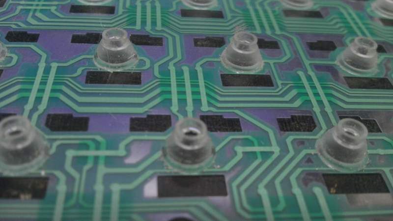

Long story short I want to Mount a Computer inside an Antique typewriter maintaining the look and feel of the antique. My initial plan is to dissasemble a Toshiba Satellite and disgard any thing I don't need (plastic housing, Maybe the speakers, and any chassis' I can do without) I have so far stripped the keyboard down to Flexible circuit board, and am looking for ideas on how to make the keys of the old typewriter activate the corresponding keys on the circuit board. This is The biggest problem I have with the project, I see it being very do able. underneath there are arms of metal that move about 3 -5 MM and I could make small contact swithces, very easily.What could I use to translate the contact switch to the digital keyboard that would be long lasting with minimal maintence? and where is the cheepest place to acquire such material, and what kinds of tools will I Need, I have basic tools, and can acquire specialty tools with in financial reason.

all I want to do is basically extend the keyboard switches. each key has a simple I/O switch that is activated by completing a circuit. I would like to solder wires to both ends of the I/O swithch contacts and allow them to complete there actions in a remote location that is traversed via wire.
Can I do this?
my guess is that I am going to run into power issues.
i suppose another option would be to build an entire new circuit system, however interfacing that back to the computer and creating a driver to make the new circuit funtional is a bit beyond my abiility at this time.
I would suggest looking into using a microcontroller to translate the contact switches from the typewriter keys to the digital keyboard. This would allow for a more reliable and efficient connection between the keys and the circuit board. Additionally, you may want to consider using a Raspberry Pi or Arduino board to control the microcontroller and integrate it with the computer.
In terms of tools, you may need a soldering iron, wire cutters, and wire strippers to connect the microcontroller to the circuit board. You may also need some basic programming skills to program the microcontroller.
As for acquiring materials, I would suggest looking online for electronic components suppliers or visiting a local electronics store. It may also be helpful to reach out to online communities or forums for advice and recommendations on specific materials and tools.
