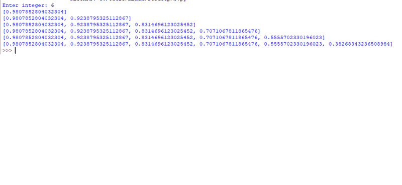

Take as input from the user an integer N. We don't want the user to enter very large integers, so exit with an error message if N>20. You may assume that N is an integer (and not a real number) and also that it is positive. Make two vectors v1 and v2 using v1.append() and v2.append() to fill in these vectors in the following way:
  • nth element of v1 should be cos(pi*n/16)
  • nth element of v2 should be sin(pi*n/21)
Finally find the scalar product of the two vectors.
Here is my code
Python:
#!/usr/bin/python
N=int(input('Enter integer: '))
if N>20:
    print ('error')
    exit ()
elif N<20:
    v1=[]
    for n in range (1,N+1):
        import math
        x=math.cos(math.pi*n / 16)
        v1.append(x)
        print (v1)
Problem is it takes v1 for every n so its like v1=[x1] then v1=[x1,x2] v1=[x1,x2,x3] it prints all like this
But I just only want the last one. How can I choose it ?
Thanks
It's not clear to me what you're asking -- the "last one" of what?
First interpretation: you just want the last element of an array
use of the minus one index position gets the last element in your array / list.
Second interpretation: you want the final print stmt only
just move the print statement out of that for loop by 'de-indenting' it
Important point:
Your if statements are incorrect. As is they don't address the N=20 case (contra to problem directions). If you choose to do an "elif" you need to get the inequalities right -- just using an "else" statement is easier and less error prone here, I think.
For example İts like this for N=6 there's 6 v1 vector. but I only want the last one (I think that's the right way to solve the problem)
Not exactly.. umm I want only the last array then I ll do the same thing for v2 then I ll multiply those.
Oh wait that's the answer I guess
I can't tell whether the real issue is understanding how to manipulate a list, or understanding how for loops work, or understanding how whitespace works in Python, or something else.
For avoidance of doubt, there is no "last array" here. The way to think about it is: your code only has one array (actually a list) that you are appending to, via a command called "append". There aren't multiple arrays here -- just one, that you're growing over time via the 'append' operation. After that for loop is done, you only have that 'fully grown' list.
If you 'de-indent' the print stmt, you won't be doing a print at every iteration of the for loop, and instead you'll just do a single print once you've completed the for loop (and only see the 'fully grown' list).

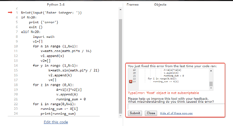

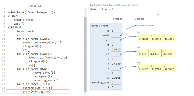

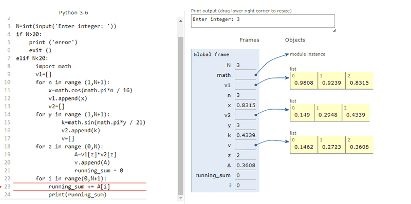

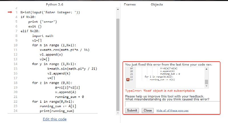

Okay here my last work , please help me..
Python:
#!/usr/bin/python
if N>20:
    print ('error')
    exit ()
elif N<20:
      import math
      v1=[]
          v1.append(x)
          v2=[]
      for y in range (1,N+1):
              k=math.sin(math.pi*y / 21)
              v2.append(k)
              v=[]
      for z in range (0,N):
                  A=v1[z]*v2[z]
                  v.append(A)
                  running_sum = 0
      for i in range(0,N+1):
          running_sum += A[i]
          print(running_sum)

Okay I did it
Arman777 said:
Okay I did it
What does this mean? Does it mean that you got your code to work?

Mark44 said:
Finally, you don't need to have a third array v[], as this is a waste of computer memory. Instead, you can do this, which is pretty much what Stone Temple Python was saying:
Arman777 said:
Well I tried that but I couldn't do it.
Look at the bottom of my code in post #13.
Mark44 said:
You should NOT have v2 = [] as part of the first loop. In other words, this line should NOT be indented.
You should also NOT have v = [] as part of the 2nd loop.
Arman777 said:
Is that changes anything ?.
Yes. You are essentially declaring your two arrays in each loop iteration. This is inefficient.
Arman777 said:
Okay, I changed that well, does it make difference? don't get me wrong I am really asking since I want to learn.
That's good that you want to learn. My comments are intended to be constructive criticism, to help you understand your code better, and to write better code. Unlike C, C++, C#, Java, and many other languages, Python doesn't use braces { } to delimit blocks of code. Instead, Python uses indentation.
In Python, there's a difference between these two snippets.
1.
Python:
sum = 0
for i in range(0, 6)
    sum += i
    print(i)
2,
Python:
sum = 0
    sum += i
print(i)
In the first example, the print statement executes 6 times. In the second example, the print statement executes only once.
Arman777 said:
I did a check to see that our codes give the same result or not and they don't I wonder why?.
Because my indexes range from 0 through N - 1, and yours range from 1 through N -- that's why.
The problem statement didn't specify whether n should start from 0 or from 1. I think the intent was that it should start from 0, but you would have to ask your instructor which of these was intended.
