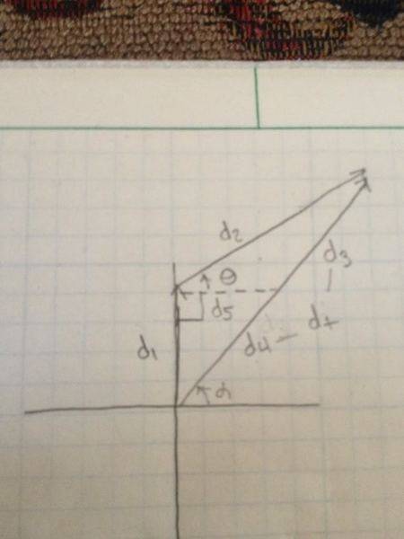

1. Sir Killalot's foe Dead Metal is due north of Sir Killalot's position and at a distance of 12m. Dead Metal moves 15m at an angle of 30 degress to a new location. How far and in what direction should Sir Killalot move to intercept Dead Metal?
He gave us the answers, but I'm not sure how to find the solution
Answer: 23.4m @ 56.3 degrees
2. A bug has a displace ment along a line which make an angle of 70 degrees to the x axis. (a) How far from the origin must the bug be located so that its displacement from the origin has an x component of 45cm? (b) What is the y component of the bug's displacement?
Answer: (a) 132cm; (b) 124cm

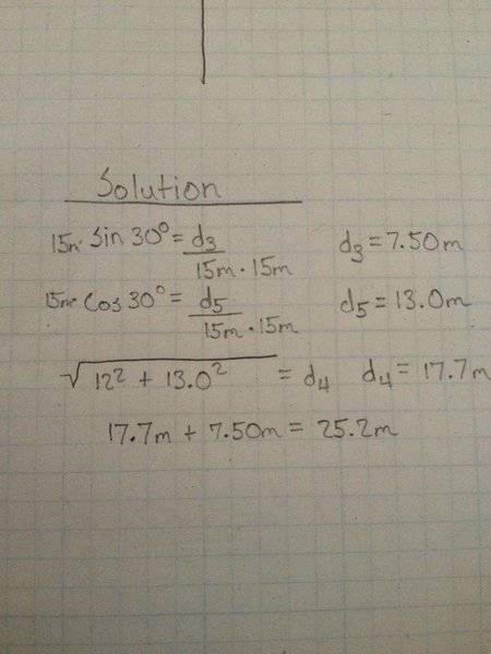

I worked the both of them. I got number 2. I'm still having a little trouble with number 1. I'm not sure how to get the angle or direction he is going. Also I got 25.2 instead of 23.4. I like using the trig functions, but my professor, for whatever reasons, frowns upon them. He believe in adding and subtracting vectors, but adding and subtracting doesn't make much sense to me. I think the term he used for solving vector addition/subtraction problems was resolution components?
This is what my professor prefers- Dxy=Dx+Dy or Dx=Dx1+Dx2 and Dy=Dy1+Dy2
I don't particularly care for it, but I guess I have to play by his rules.
Place SK at the origin or your coordinate system. Draw a vector from there to DM's initial position. Call that [itex]\vec P_1[/itex]. What are the components of that vector? Now draw a vector from DM's initial position to his final position using the information given, and call it [itex]\vec P_2[/itex]. What are the components of that vector relative taking [itex]\vec P_1[/itex] as the origin? Now add the two vectors.
show us what you did :smile:
Sorry for such the large pictures. Tiny tim, could you explain to me how this coordinate process works? That's the part I don't understand about adding/subtracting vectors.
Hi Wats!
In (x,y) coordinates, the first vector is (0,d1), and the second vector is (d2cosθ,d2sinθ).
Then just add the coordinates. :wink:
Oh ok. I think I'm beginning to understand. I should of drawn another triangle with the unknown vector being the hypotenuse. How would i find alpha though?
Consider a plane with the usual x-y coordinate system. Any point in the plane thus has two coordinates: x and y. A vector in the plane can be treated the same as a point: put its tail at the origin and its head will be at some point that will have x and y coordinates. These are called rectilinear coordinates.
You can also identify any point (or vector) using polar coordinates, that is, a distance and an angle (conventionally measured counter-clockwise from the x axis), conventionally called r and θ.
In this problem you are given the length and angle of a vector (the second vector), and you have to convert from polar to rectilinear coordinates in order to easily add the two vectors. The conversion is
[tex]\begin{align}<br /> x &= r \cos\theta\\<br /> y &= r\sin\theta.<br /> \end{align}[/tex]
All you have to do is convert the second vector and then add it to the first, then convert back to polar coordinates. That conversion should be obvious from the above equations.
You mean the angle of the third vector?
If it's (A,B), then tanα = B/A. :wink:
