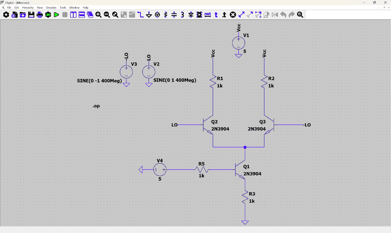

TL;DR Summary: Struggling to implement a BJT Mixer, which is part of implementing RADAR transmitting at 600MHz in LTspice.
I am attempting to implement RADAR in LTspice. At the moment, I am trying to implement the following three blocks that would make up the transmitter of the RADAR: power amplifier, Upconvert (Mixer), filtering.
I am trying to implement a single balanced BJT Mixer, but in doing, so, I am realising how much I don't know about what I am doing. I have access to an oscilloscope and function generator.
What I have done so far:
LTspice schematic of a single balanced BJT mixer: two NPN transistors Q2 and Q3 with 1k collector resistors R1 and R2 to Vcc, LO inputs from sine sources V2 and V3, and a common-emitter pair driven by Q1 through R5 and R3.

Why do you need 600 MHz radar? GPR? You will need a licence to transmit radar signals on 600 MHz. I assume you are building pulse radar, have you considered chirp or frequency swept radar?
SumDood_ said:
Meaning, would a mixer's transistors all be biased to the same region? Is it acceptable to use the same bias signal to bias all the transistors?
The same DC bias voltage goes to the bases of the differential pair, but they are decoupled with resistors to prevent RF crosstalk. The bias current is set by the lower BJT, Q1, with resistor R3, so the transistors will both be biassed on.

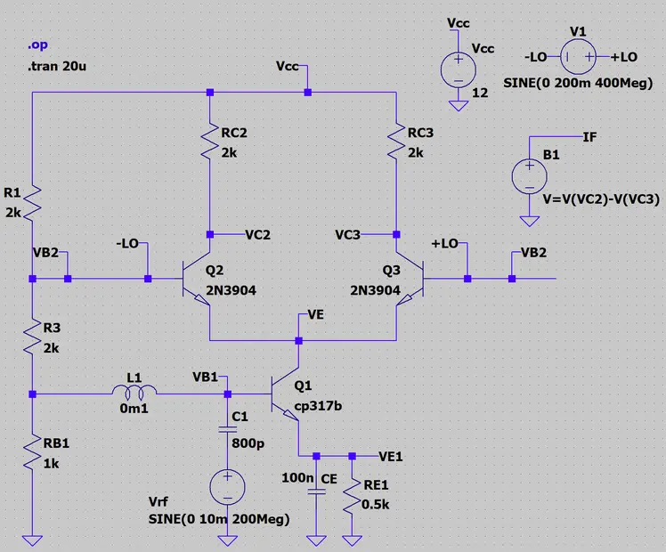

LTspice schematic of a single balanced BJT mixer with two differential transistors Q2 and Q3, a common-emitter transistor Q1, LO source V2 and RF source Vrf, and bias resistors and sources.
LTspice FFT plot of V(out) on a log frequency axis from about 1 kHz to 300 MHz against dB from -200 dB to -50 dB, with a dense green spectrum that rises in noise and spikes toward higher frequencies.
It does not perform as expected because the bias voltage for the lower stage, Q1, is the same as the bias voltage for the differential pair, Q2, Q3.
Also, the LO, -LO signal is not connected to the pair.
You need to think in terms of current flow, not voltage when working with BJTs, but you must then make sure there is sufficient voltage compliance, headroom, where stages couple directly.
Your Q1 sets the bias current of the differential pair. Q1 base needs to be biassed sufficiently above ground, so it does not clip when driven by the LO = 10 mV input. You should lower the V4 bias voltage to about 2 volts, which will move the Q1 collector well below the differential pair emitter voltage. Then it should work. Adjust the Re1 to set the bias current for the pair.
Differential pair Ibias = ( Vbias - Vbe ) / Re1.
When you plot the TR against time, also plot your bias voltages, so then you can see the signals do not clip due to stage bias voltage.

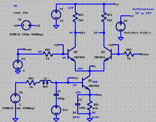

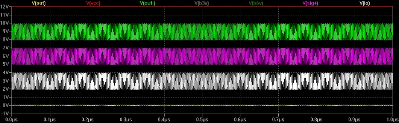

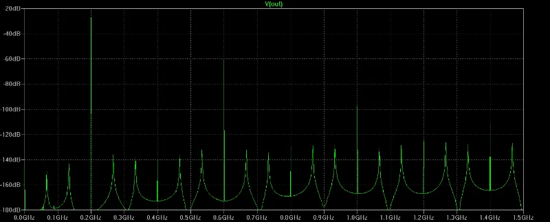

Here is another implementation. The bigger LO goes to Q1, while the smaller signal goes to the differential pair, which is normal practice with BJT mixers.
LTspice schematic of a single-balanced BJT mixer: differential pair Q2 and Q3 fed by a 10 mV SINE signal source, with Q1 driven by a 400 MHz LO source, bias chain resistors R5 and R6, and output B1 with V=V(out+)-V(out-).
In the FFT, see how the 400 MHz LO is rejected by the mixer. In place of a centre-tapped primary output transformer, an LTspice Bv device subtracts the IF outputs, to convert differential to single sided for the FFT, or you would not see the cancellation of the LO in the simulation.
LTspice FFT plot of V(out) in dB from 0 to 1.5 GHz, showing a tall spike near 0.2 GHz and smaller spikes at regular intervals, with a dip near 0.4 GHz.
All bias voltages are derived from one chain of resistors. Notice how the signals are separated by voltage, so they operate without clipping, each with sufficient headroom.
LTspice transient plot with seven stacked traces over 0 to 1 µs: V(out), V(vcc) at 12V, V(out-), V(b3v), V(b6v), V(sig+) and V(lo), each a dense oscillating waveform at its own voltage offset.

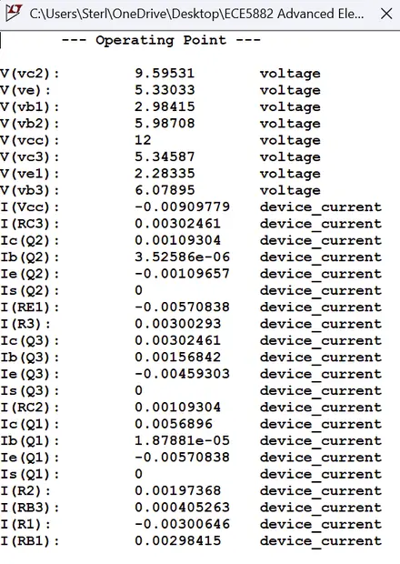

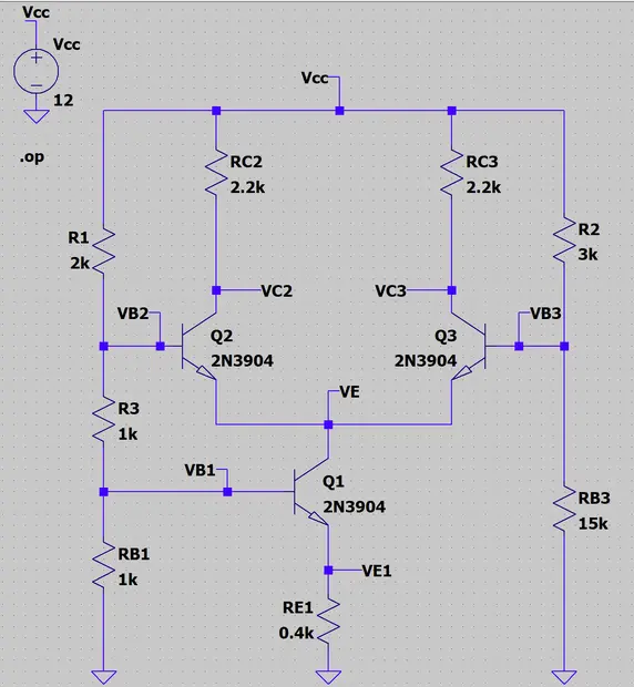

I have been trying to bias my initial topology using a bias chain. I can't seem to push Q3 VCE. I have been unsuccessful as well when trying to reduce VE through RE1. I'd appreciate any advice in understanding what am I doing wrong. I believe Q1 and Q2 are biased correctly but Q3 isn't.
LTspice schematic of a BJT differential pair with a current source, Q1 driving emitters VE of Q2 and Q3 (2N3904), collectors via RC2 and RC3 2.2k to Vcc 12 V, bias resistors R1 2k, R2 3k, R3 1k, RB1 1k, RB3 15k, RE1 0.4k, with nodes VB1, VB2, VB3, VC2, VC3, VE, VE1 labelled.
LTspice operating point report listing node voltages and device currents for a BJT circuit, including V(vc2) 9.59531 V, V(ve) 5.33033 V, V(vcc) 12 V, V(vc3) 5.34587 V, V(ve1) 2.28335 V, V(vb3) 6.07895 V, with currents for Q1, Q2 and Q3.
Your Q3 is saturated. That is because there is a DC voltage difference between the VB2 and VB3. The important thing about differential pairs, and balanced mixers, is symmetry. The same divider chain must provide the bias voltage to both Q2 and Q3, or it will not balance.
The voltage VE1 is controlled by the highest base voltage of the differential pair, not by the current being sunk by the Q1 collector.
Maybe you are not thinking like a BJT.
Set the base voltage of the NPN transistor.
Think of the base-emitter as a forward biassed diode.
The emitter voltage will be about 0.7 volt below the base.
The current sunk from the emitter is decided by; Ie = Ve / Re.
Of the current supplied from the emitter, 1% will come from the base, 99% will come from the collector.
The collector just sinks the current needed.
Vc is determined by the collector circuit load resistance.
Vc = Vsupply - Ic * Rc .
For Q1, Vb1 is set at about 3 V.
Ve1 will be about; (Vb1 - 0.7) = 2.3 V.
The voltage across Re1 will be Ve1, so; Ie1 = Ve1 / Re1.
For Q1; Ic1 = Ie1 - Ib1.
Ic1 will be sunk equally from the emitters of Q2 and Q3.
So they will have; Ie2 = ½ Ic1 each, when balanced.
Note that; Vb for Q2 and Q3 is set to 6 V, well above the Q1 base voltage.
We can assume that Ic2 ≈ Ie2;
Then; Vc2 = Vcc - Ic2 * Rc2 .

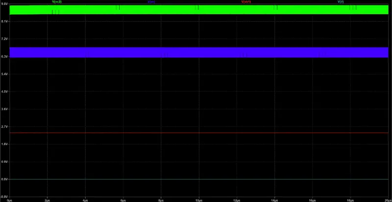

So I have managed to bias correctly, but the IF output from Bv is not expected. Though, the voltages look good to me.
Do you see what I am missing?

LTspice schematic of a single-balanced BJT mixer: Q2 and Q3 steered by -LO and +LO, Q1 as RF transistor with Vrf source, L1 0m1, C1 800p, RE1 0.5k, CE 100n, Vcc 12 V, and output IF = V(VC2)-V(VC3).
LTspice transient plot with a 0.0V to 9.0V vertical axis and 0µs to 20µs time axis, showing three nearly flat traces: green near 8.5V, blue near 6.5V, and red near 2.3V.
Your +LO and -LO are shorted together by the use of the same label VB2.
Change VB2 on the Q3 base to VB3.
The LO current would have been very high.
Edit.
I cannot check it because you re-attached the older Mixer_V3.as.txt
Oh sorry about the file, here is the correct one.
Edit: It seems to be working now, but I am kind of confused. I was using the net label VB2 so that both Q2 and Q3 are biased in the same manner. But I changed VB2 to VB3 and Q3 is still working? Like, didn't I just remove the DC biasing by removing net label VB2?
That is because your ±LO, (AC voltage source), was kind enough to do that DC biasing for you. If you had a DC offset in the ±LO source, it would not have worked.
Symmetry is important in the real implementation. The ±LO will probably be the secondary of an RF transformer. Then the transformer will be centre tapped, or it would employ two equal value bias resistors from the same voltage source.
You are still operating with your low-amplitude signal to Q1, and the high-amplitude LO to Q2,3. In post #8, I showed how to flip that.
Then you will have better gain and linearity in the small signal path, and by removing Ce from Q1, better linearity for the LO.

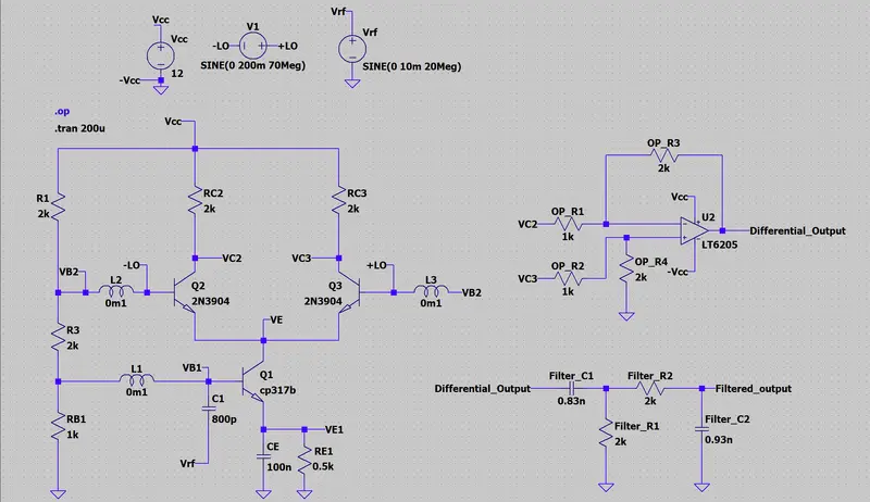

I have made a few changes and implemented a differential amplifier that seems to be working. Now, I have an issue with passive filtering. I am trying to implement a band-pass filter that is centred around the IF. It seems to be not acting as a band-pass filter but attenuating the output signal into uV.
Also, CE at Q1, seems to be helping with reduced noise.

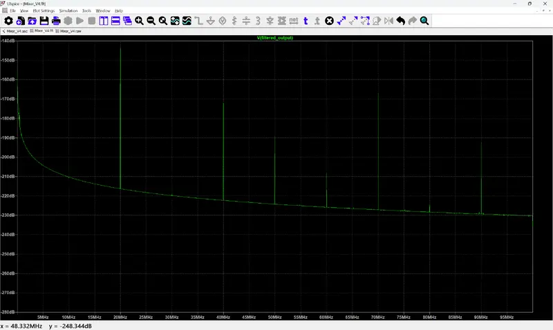

LTspice schematic of a balanced BJT mixer with a differential amplifier output stage and a passive RC filter section labelled Filter_C1, Filter_R1, Filter_R2 and Filter_C2 feeding Filtered_output.

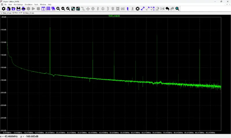

Without Filtering:
LTspice FFT plot of V(if_output) from 0 to 100 MHz, in dB from about -260 to -80 dB; a noise floor slopes down from about -120 dB at low frequency to about -190 dB, with sharp spikes near 20, 40, 50, 60, 70 and 80 MHz.

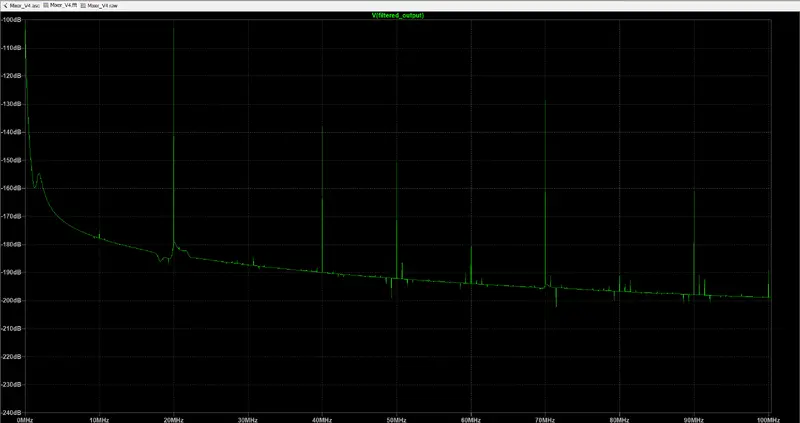

With Filtering:
LTspice FFT plot of V(filtered_output) in dB against frequency from 0 to 100 MHz, showing a decaying noise floor near -220 dB with sharp spikes at multiples of 10 MHz.
What frequency is your IF ?
Check the bandwidth of the OP07 op-amp.
The op-amp difference voltage will be near DC zero volts, which is too close to the negative supply rail.
Quick fix, do not connect OP_R4 to ground, connect it to VB2, then op-amp signals will be near mid-supply.
Your passive BPF is centred on 100 kHz, but there is no signal that low in frequency.
The IF frequency is 90MHz.

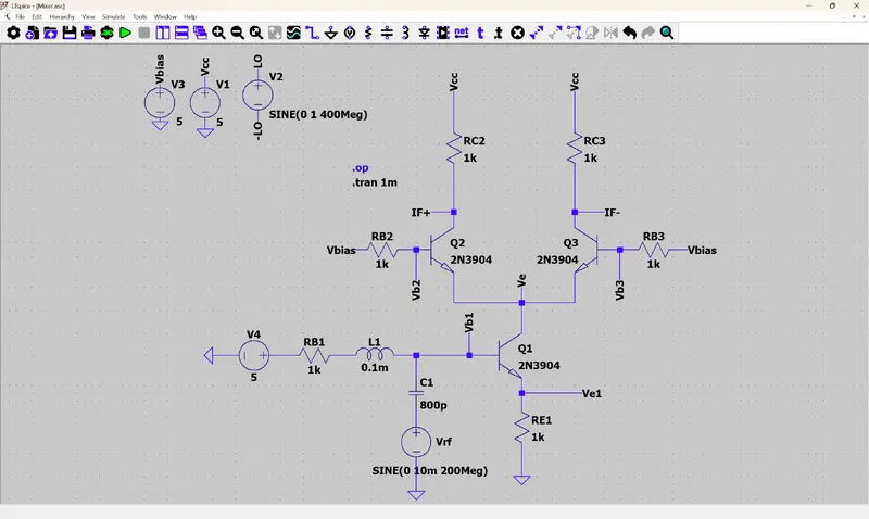

I changed the op-amp to one that is more suitable. Though, there is still significant attenuation after I pass the differential output through a filter. If I connect VB2 instead of ground, the FFT is much noisier. Not sure if that is worth it.
What is a bit confusing is that the filter doesn't seem to be working as intended.
LTspice FFT plot titled V(filtered_output), magnitude in dB from 0 to 100MHz; peaks rise above the floor at roughly 20, 40, 50, 60, 70, 80 and 90MHz, with the floor falling steadily from about -100dB at low frequency to about -200dB.
LTspice schematic of a single-balanced BJT mixer with a differential op-amp output stage and a low-pass RC filter. Q1 is cp317b; Q2 and Q3 are 2N3904, with a 2k collector resistor each.
Your simulation is now so far from reality, that it is more a work of art than engineering. Your project has lost touch with reality, it has become a house of SPICE cards.
It is noisier because the op-amp is functioning, rather than being driven hard against a supply rail. You need to check the range of input voltages that can be sensed by the op-amp, and the range of output voltages that can result.
No engineer would use an op-amp in that situation. They would use a transformer with a centre tapped primary, then integrate the secondary into the following BPF. The modest amplifier gain could be obtained by changing the turns-ratio of the transformer.

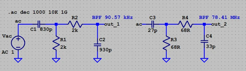

That is because it is designed for the wrong IF frequency. The BPF is also a passive RC filter, which has a significant in-band loss. Signal is too valuable a resource. It should not be thrown away so carelessly.
Schematic of two cascaded passive RC band-pass filters in LTspice: source Vac with C1 830p, R1 2k, R2 2k, C2 930p (BPF 90.57 kHz) and C3 27p, R3 68R, R4 68R, C4 33p (BPF 78.41 MHz).
