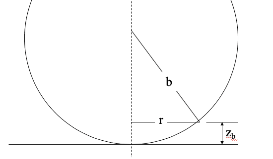

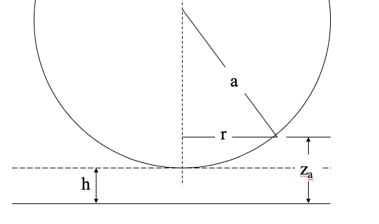

Yes. Let P be a horizontal plane tangent to the larger sphere b at its base. We wish to determine the elevation ##z_b## of the surface of b above the plane P as a function of the radial distance r measured from the vertical axis of the sphere. If we draw an appropriate right triangle in the diagram, we can use the Pythagorean theorem to show that $$(b-z_b)^2+r^2=b^2$$If we linearize this with respect to ##z_b##, we find that: $$z_b=\frac{r^2}{2b}$$Similarly, for the sphere a, we find that the elevation of its surface above the plane P (tangent to b) is
$$z_a=h+\frac{r^2}{2a}$$Therefore, the gap between the two surfaces H(r) is given by
$$H(r)=z_a-z_b=h+\frac{r^2}{2a}-\frac{r^2}{2b}$$

The answer you gave has a typo in it. The plus sign should obviously be a minus sign. Here are two figures for determining the distance of the surface of each sphere above the bottom plane.
Geometry diagram of a sphere of radius b resting on a horizontal plane, with a dashed vertical axis, radius r marked horizontally and height z_b marked vertically to the sphere surface.
Diagram of a sphere of radius a resting above a horizontal plane, with its lowest point at height h, showing a radial distance r and height z_a measured from the plane.
We are not moving the two spheres around anywhere yet. From these two figures, the gap between the two spheres is
$$H(r)=z_a-z_a=h+\frac{r^2}{2a}-\frac{r^2}{2b}$$ The only parameter that is changing with time is h.
