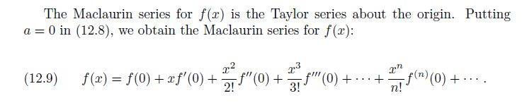

Maclaurin: ## f(x) = f(0) + f'(0) + f''(0) ... ##

This is not the correct formula for the Maclaurin series.

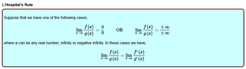

Although I would not recommend it for this problem, you should be aware of the L'Hospital's Rule.

Ok, I am even more confused now as far as the statement "that is not the correct formula for the Maclaurin series", as it is exactly what it states the Maclaurin as in our book (attached image) literally right before the problems that tell you to specifically use the Maclaurin series. So you're saying the book is wrong??? So what is wrong about it?
As far as the ##lim f'(x)/g'(x)##, I don't get that either. If I were to take the derivative of the top and bottom of this equation, I would get ##2/(2e^{2x})##. So with that one, it would simplify to ## (e^{2x})^{-1} ##, and would be extremely simple from there. But, I tried that as well, and that gives me the wrong answer too. So, why is that approach not working for this equation?

This is what I see in your original post:
That is not the Maclaurin series.

Right. (But in this case you should not use 'f' to represent the numerator. You are already using 'f' to represent the original function. Use something else.)
So this gives ##f(0) = [2x/(e^{2x}-1)]|_{x=0} = [2/(2e^{2x}]|_{x=0} = 1##, which is the correct limit at the undefined point, x=0.

L'Hospital's Rule does work. You should check your work again.
