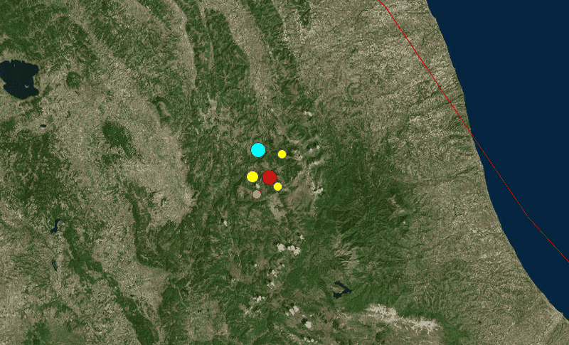

Italy getting hammered again
another quake coming in on my recorder as I type this ... M 6.6 - 6km N of Norcia, Italy
It's in the same area as the other recent ones
the red one is the current 6.6, the blue one is the 6.1 of about a week ago
Dave
