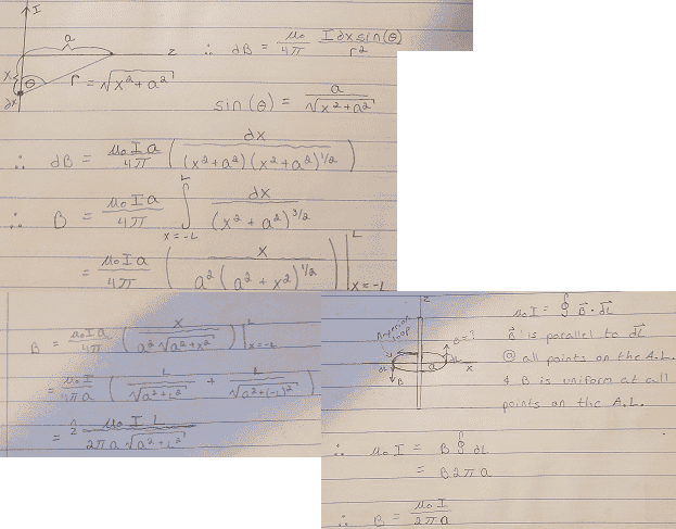

A wire carrying a current I in the positive x direction is located along the x axis. The wire is of finite length and is located between x = -L and x = L. Find the magnetic field at a field point located a distance a away from the wire.
Biot-Savart law
Ampere's law
[/B]
I solved the problem above and its the same as the professors so its correct. However, I was following along with a video I found on lassevrien's channel on YouTube:
and he attained a different answer for what I believe is the same problem. If you don't want to watch the video I have summarized it on the picture (lower right); he is using Ampere's law.
So I figure if I evaluated my answer from -∞ too ∞ I would get what he got but I am getting an undefined answer. Are these two methods of doing the same problem? Am I just evaluating wrong?
That is in general a very dangerous assumption: to err is human and professors are human
How so ?
BvU said:
How so ?
I believe B would be undefined here:
$$B =\frac{μI}{4πa} (\frac {∞} {\sqrt{a^2 +∞^2}}\frac {∞} {\sqrt{a^2 +∞^2}}),$$
Divide numerator and denominator by ##L## before letting ##L## go off to ##\infty##
I am not sure if this is what you meant but here goes:
$$\lim_{x \rightarrow +\infty} {\frac {x} {\sqrt{a^2 +x^2}}}$$
$$\lim_{x \rightarrow +\infty} {\frac {(\frac{1}{x})x} {\sqrt{\frac{1}{x^2}}\sqrt{a^2 +x^2}}}$$
$$\lim_{x \rightarrow +\infty} {\frac {1} {\sqrt{(\frac{1}{x^2})(a^2 +x^2)}}}$$
$$\lim_{x \rightarrow +\infty} {\frac {1} {\sqrt{\frac{a^2}{x^2}}+1}}=1$$
Brilliant ! Now add 1 and 1 :wink: .
Well, almost brilliant: not $$ \lim_{x \rightarrow +\infty} {\frac {1} {\sqrt{\frac{a^2}{x^2}}+1}}=1$$ but $$
\lim_{x \rightarrow +\infty} {\frac {1} {\sqrt{{\frac{a^2}{x^2}}+1}}}=1$$
Got it, thanks man.
You are welcome.
