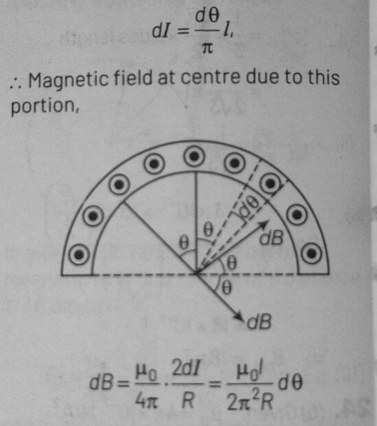

An infinite wire has semi-circular cross section with radius R. It carries current I. Then the magnitude of magnetic induction along its axis
Field due to infinite wire=##\frac{\mu_○I}{2\pi d}##
I proceeded as follows
Current in sector ##d\theta=## is:
$$dI=\int_{x=0}^{x=R}{\frac{I}{\pi R^2/2}\times\frac{d\theta}{2\pi}\times 2\pi x dx}$$
Field due to sector ##d\theta## is therefore
$$dB=\int^{x=R}_{x=0}{\frac{\mu_○}{2\pi x}\times\frac{I}{\pi R^2/2}\times\frac{d\theta}{2\pi}\times 2\pi x dx}$$
$$\implies dB=\frac{\mu_○IR}{\pi^2R^2}d\theta$$
For the entire wire:
$$B_{net}=\int^{\pi}_0{dB \cos(\theta-\pi/2) \hat i} + \int^{\pi}_0{dB \sin(\theta-\pi/2) \hat j}$$
Finally$$ B_{net}=\frac{2\mu_○I}{\pi^2R}$$
This is double the correct value? What did I do wrong ? Why does the book give this answer?
I don't understand what you are doing here: $$dI=\int_{x=0}^{x=R}{\frac{I}{\pi R^2/2}\times\frac{d\theta}{2\pi}\times 2\pi x dx}.$$ The semicircular ring of radius ##R## is very thin and there should be no ##\pi R^2## term to consider. Assume that the current is uniformly distributed over the ring. An arc ##ds=R ~d\theta## has current $$dI=\frac{I}{\pi R}ds=\frac{1}{\pi}I~d\theta.$$ Consider that as an infinitely long wire, find the two components of its contribution ##dB_x## and ##dB_y## at the center and integrate over ##\theta##. The vertical component is expected to integrate to zero by symmetry. That's how one adds vectors.
