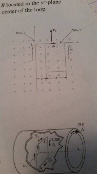

Consider the figure on the right. Wire 1 is oriented along the y-axis and carries a current I1. A rectangular loop located to the right of the wire in the xy-plane carries a current I2. Find the magnetic force exerted by wire 1 on the top wire of length b in the loop labeled, "Wire 2" in the figure.
2. Homework Equations
Biot-Savart Law
I'm not sure where to begin. I've never worked with a problem like this before, only the basic problems.[/B]
